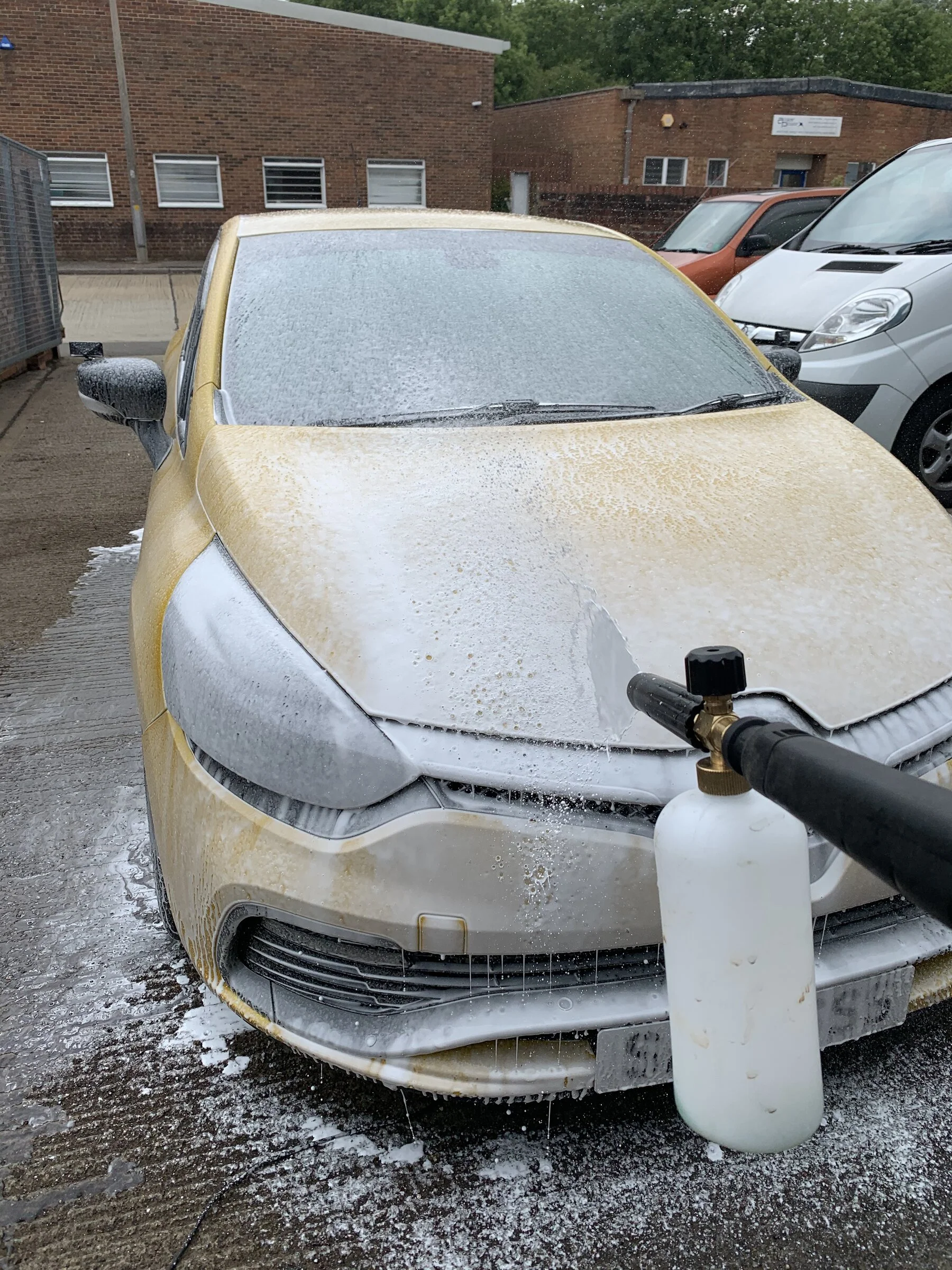

Using Power Maxed Blizzard snow foam at roughly 10:1 ratio and all I’m getting is a very watery foam.
Using a brand new Karcher K4 full control pressure washer and I’ve tried two different lances. Dial is turned to max foaminess
Has anyone else experienced this piss poor performance issue?!
I thought it was because my little old K2 pressure washer was leaking more water out the pump body than through the lance as to why it was such a poor foam but I’m getting similar results with a decent amount of water pressure.
The recommended dilution is 33:1....

What snow foam are you using?
I might try a different brand to see if that makes a difference. I used to get good results with a snow foam that was blue in colour but can’t remember for the life of me what it’s called!!

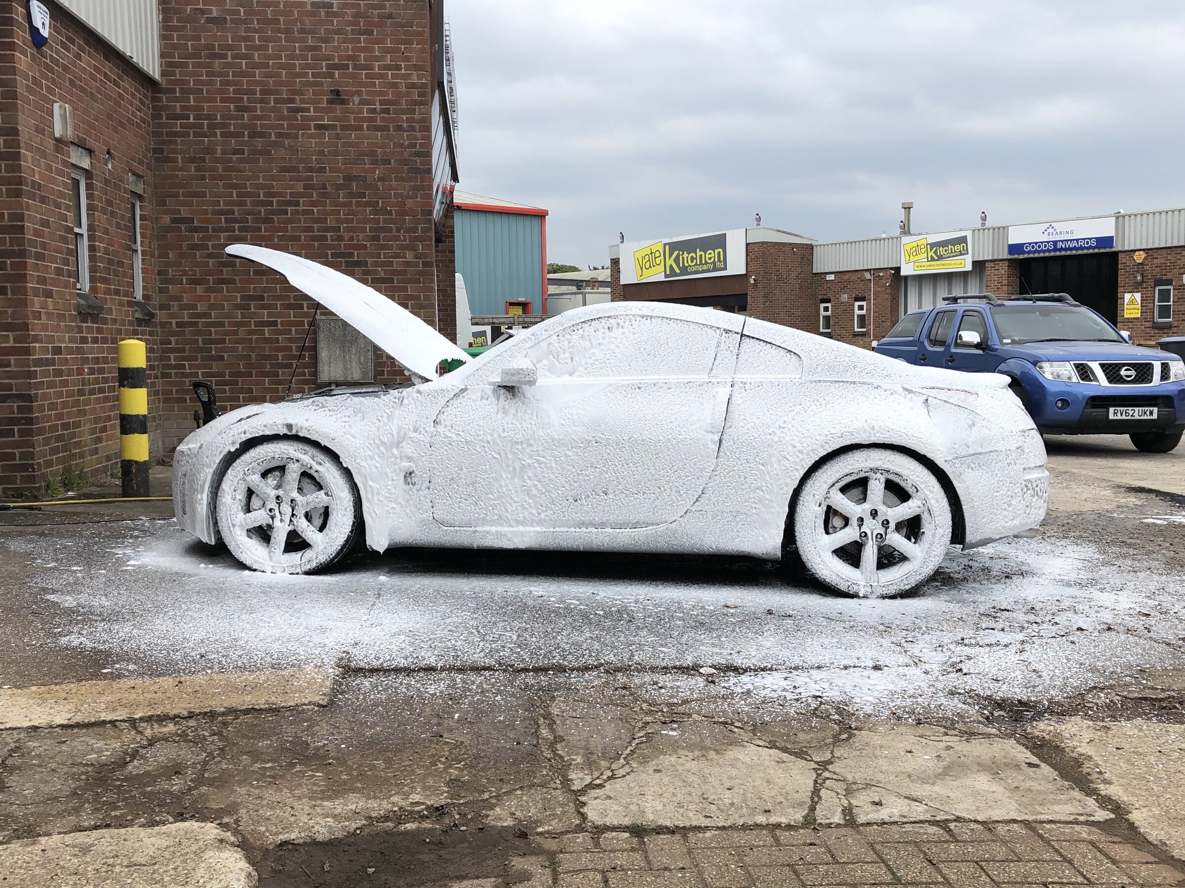

Not all foams are ‘foamy’
It’s just how they work. Bilt and Hamber is one of the best cleaning foams out there in my opinion, but it’s like water.
Then on the other hand you’ve got something like Autobrite Magifoam which is nowhere near as good, but foams up massively and is brilliant for taking pictures for Instagram.

I've used signature candy apple, avalanche and now bilt hamber. At least the BH does a good job of removing dirt when it's gone on all pissy.

Lads. It’s a thin foam.
There’s nowt wrong with the jet wash or the lance
What this guy said. And it's super dilution
