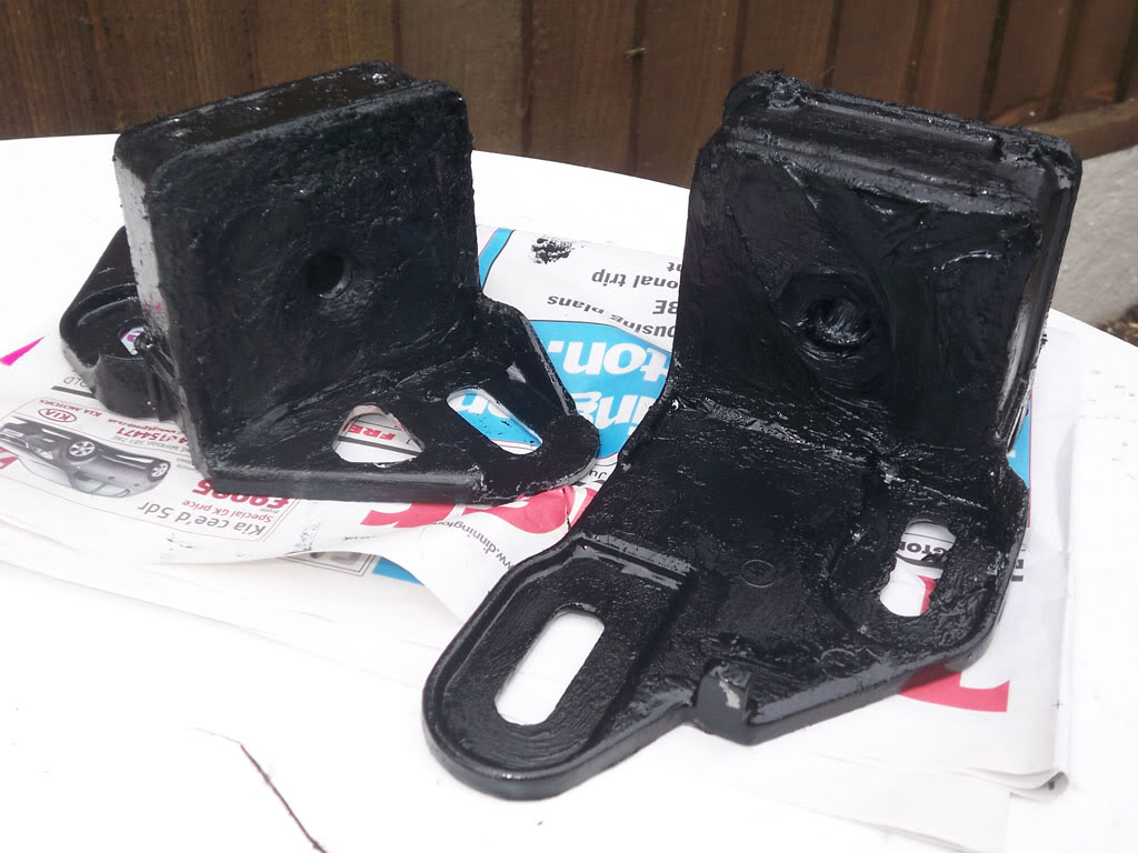

  GB 182 FF
they arrived.
They are OEM metalwork Renault logos on that part. With some hard as you like rubber in the mount.
appologies for the dire pic, i was in a rush
