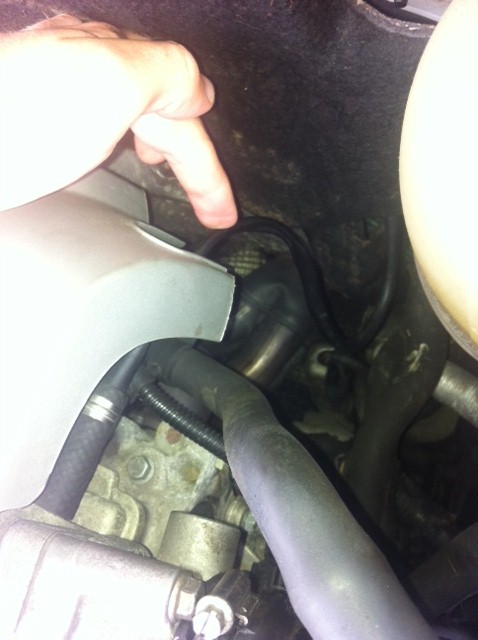

Erm yeah, that's 100% NOT right and proberbly the cause of the solid pedal.
