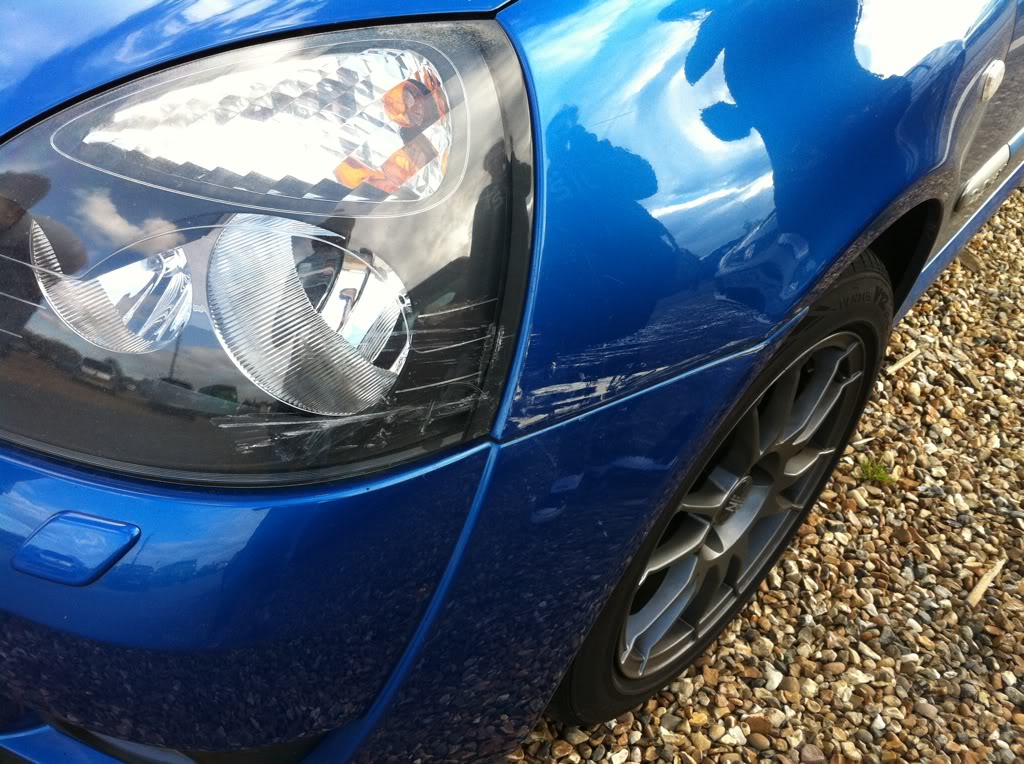

Some fucker has driven into my car whilst they were parking. Being as I live in Crawley, it's no surprise that the arsehole has driven off with leaving any details. So now I'm left to fix this....
It's worse than it looks in the picture... But I was looking for some advice on how best to clean it / remove the silver paint / make it look bit better until I can afford to get the front end resprayed....

I don't, but I can get some.... Would that be a good place to start?
Clay will not get that out mate, The headlight you should be able to do with a DA, or by hand with some wet & dry sandpaper 2500-3000 grit i think followed up by some scratch x. There is a guide somewhere check the detailing section.
As for the paintwork it depends how deep it is, again it may be some wet & dry paper then polish it out.

Cheers mate, I don't think it's too deep, haven't had a proper look yet as I was worried about making it worse. There's a tonne of paint on it, would tardis remove that? I only ask because I just bought some thismorning....

Meguaris Scratch X is pretty much bang on, it does as well as a by hand product can IMO.
The headlight will need wet and dry, then polish etc.
Get yourself a meguaris polish foam pad, then use the scratch X, finish with some SRP

Get some Autogylm paint renovator (pink label). It is an abrasive but it will remove any of the other cars paint and help to reduce the scratches. Get some Turtle Wax colour match chip stick to fill in the deep scratches, not a permanent fix but will make it look better as the wax fills in the gaps and provides a colour fill. As I said won't look great, but will look better until you decide to do something further.
As others have said, use wet and dry to sand the headlight down then buff with either the autoglym or some scratch X. Best to get a polishing pad for your electric drill (from screwfix) to make the buffing/polishing easier.

It will come out but probably not completely if you say it's worse than the picture. The headlight can be sorted but the wing will need some serious graft to get it very minimal. Had the same with my mums car.
