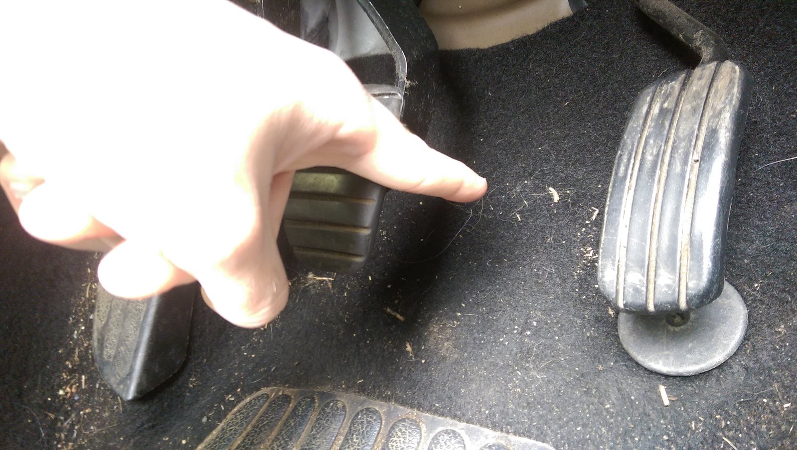

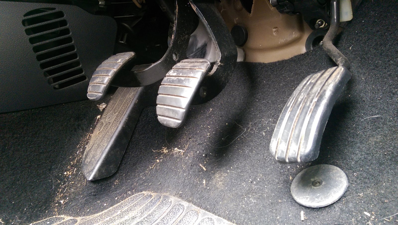

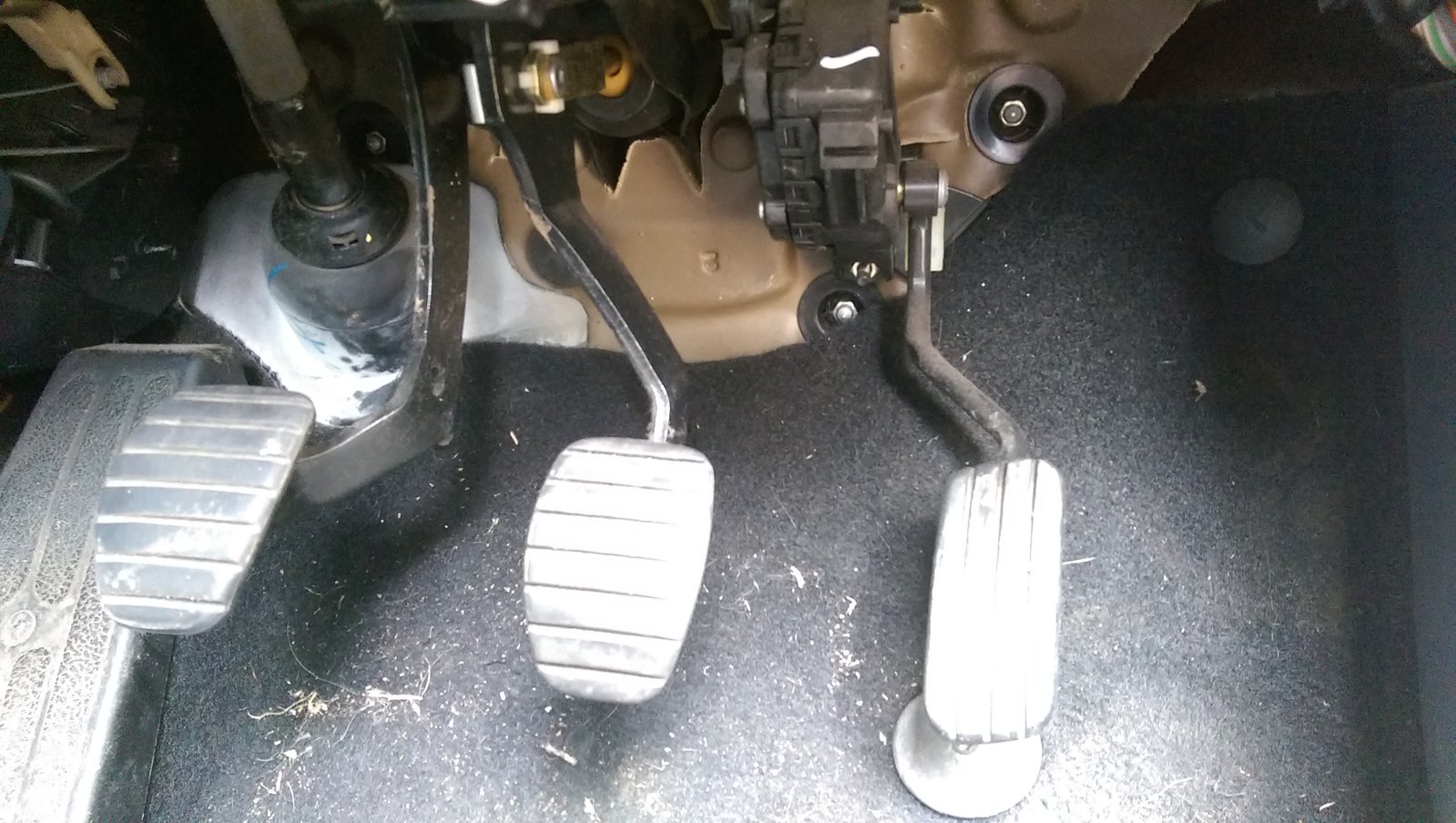

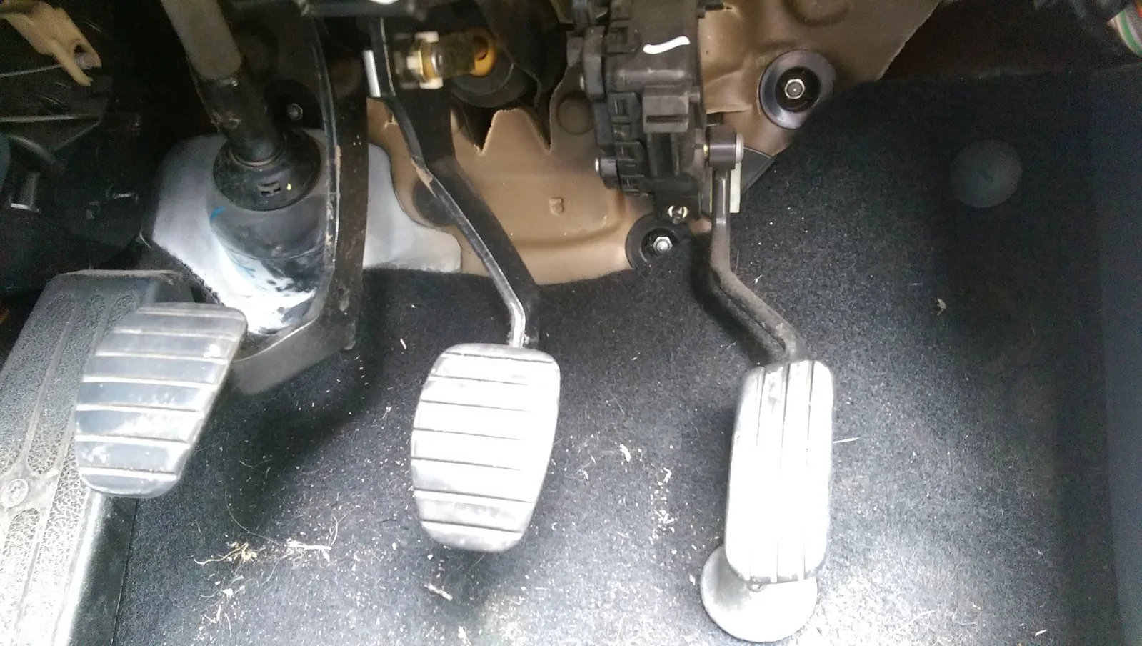

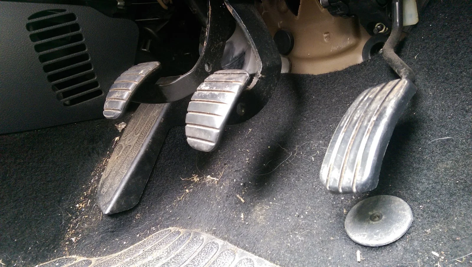

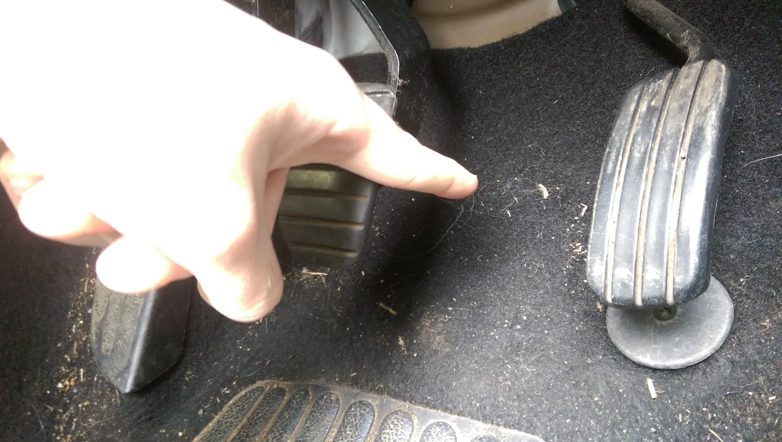

so after some looking at me peddles you may be right about the throttle being lower, I took some pictures of the difference I'll see if I can upload from my phone.
  Renault Clio 1.5Dci
These are some pictures of the peddle differences when car was idling, might be the throttle is the one that's lower which is why I have to sit close. The one with my finger is showing how far down the throttle is compaired to the brake peddle.

Worn/stretched throttle cable?
I got it sorted now, losend of a bolt holding the throttle peddle in place pulled it up and it snapped in to place inline with my other peddles. It seems a lot more responsive now also, and I'm able to heel tow :) is there a way to mark a forum as done or answered or somtbing like that?
