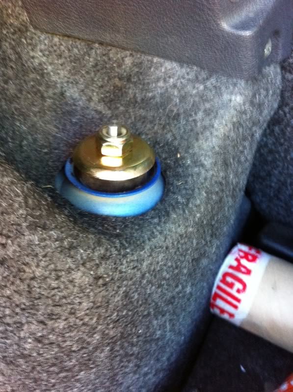

As the image says, if I leave the top gold washer I am unable to do the bolt up. Perhaps I just need someone to help push the shock up a bit so I can screw it on (doing it blind at the moment as I'm holding the shock with left hand and leaving round into the boot with my right hand). Does the car body go where I have highlighted on the image?
Any help is appreciated, thanks.
  Looking for 182
Thanks dude,
I managed to get the washer on, is this right? I assume I'll be able to tighten it all up properly once the car is back on the ground as the bolt will be pushed up through the hole a bit more.
I definitely don't need anything from the old shock?

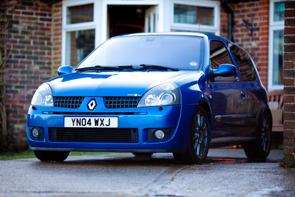

Never mind, I used my instinct and it's all on now. LOADS of scrubbing at the front and I think the back needs to be raised as it's as low as it goes at the moment.
I would say mine is sitting very similar to this but im not getting any rubbing. Mine are making a funny noise from the rear but hopefully that should be sorted tomorrow.
  Looking for 182
That first picture is exactly how I want it, but I've had to raise the fronts a fair bit, and obviously the backs now as well to keep it at least level.

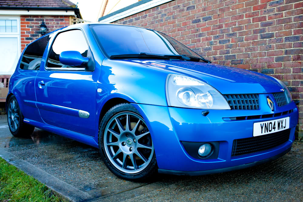

Your front is around the same as mine, check my pics thread I put up just now to compare, I defo can't go any lower plus I get some scraping issues as it is :/
  Looking for 182
Your car looks fantastic Greeny.

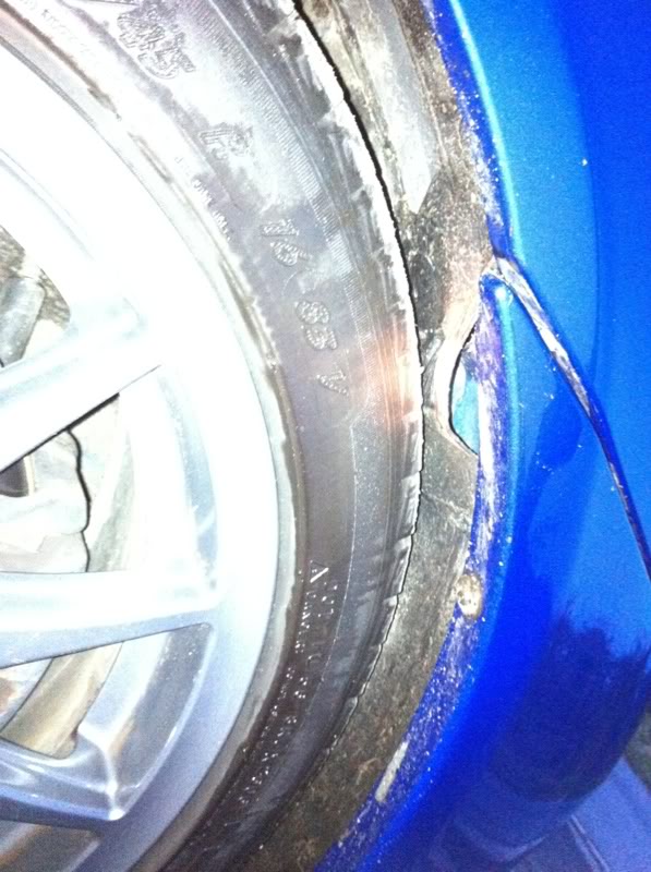

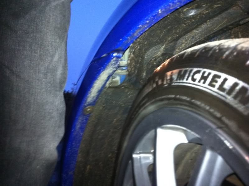

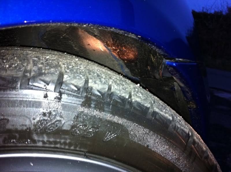

Ok, I took some pictures of where I am sure it is rubbing (definitely on the driver side as I can see it's worn slightly).
This is the passenger side, showing the arch liner which sticks out a bit. Is this what I should dremel out?
Driver's side, same deal.
Driver's side again
  ITB'd MK1
the bit of archliner that sticks out is covering the bumper to wing bolt. you can trim that bit of arch liner away, but be careful of what's behind as its sharper than plastic. Doesn't mean you can't do it, just be careful

Thanks for the heads up Danny, I'm a bit wary of removing it, as I'd prefer it to hit some smooth plastic than a metal bracket. Perhaps I need to just raise it up a bit.
I've heard of people bending the bracket itself up a bit as well. Is this a bad idea?
  Looking for 182
you can bend the bracket if you like. Just dont go mad or it makes any bumper removal/re-fitting a bit harder
Okie dokie, will take it easy. It's a bit dark now and my finger is still bleeding from fitting the coilovers so I'll have a go tomorrow.

I've just been out with the Dremel and removed the culprit, however I couldn't remove the metal bracket which is the next problem.
I took a test drive and it's MUCH better, very very slight scrubbing if I really throw it into a right (the kind of sudden turn you'd do if you were trying to avoid something). Rubbing on the driver's side when taking a fast corner quite hard (pushing it more than normal leisurely driving).
