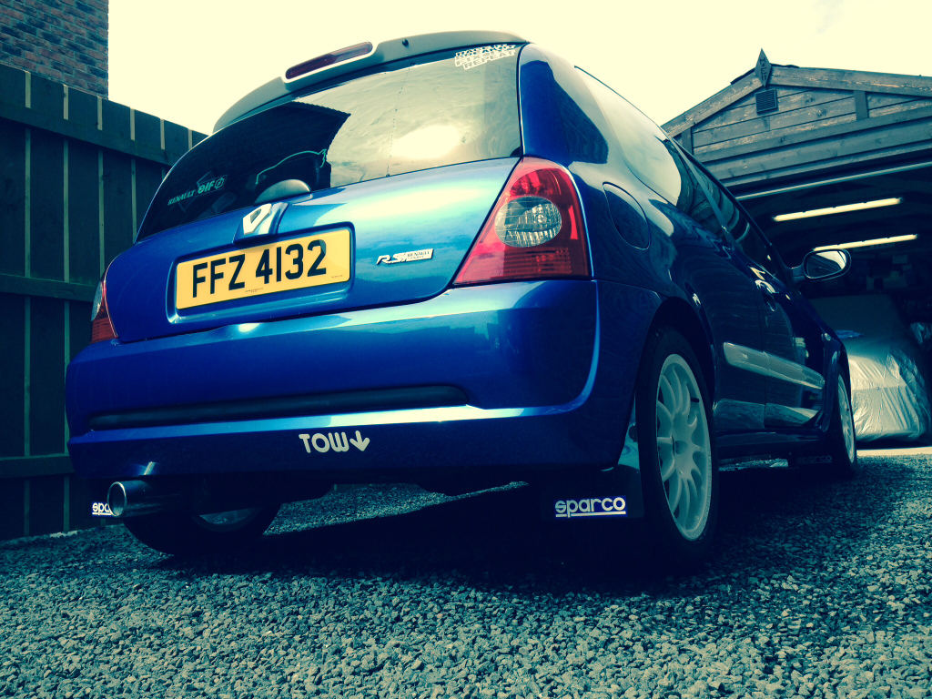

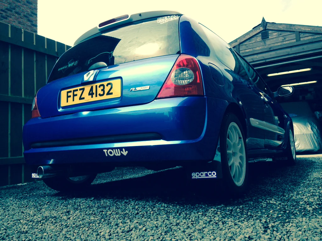

Mine are 15" +35 with 195 rsr tyres, no issues
charltjr
That's a 172 cup though, ET 35 on that is only a couple of mm difference from stock, would be 10mm on the 182 which is why I was a bit concerned. I've got my eye on a slightly unusual set in ET40, I'll post back if I get them.
Lovely looking car :)
