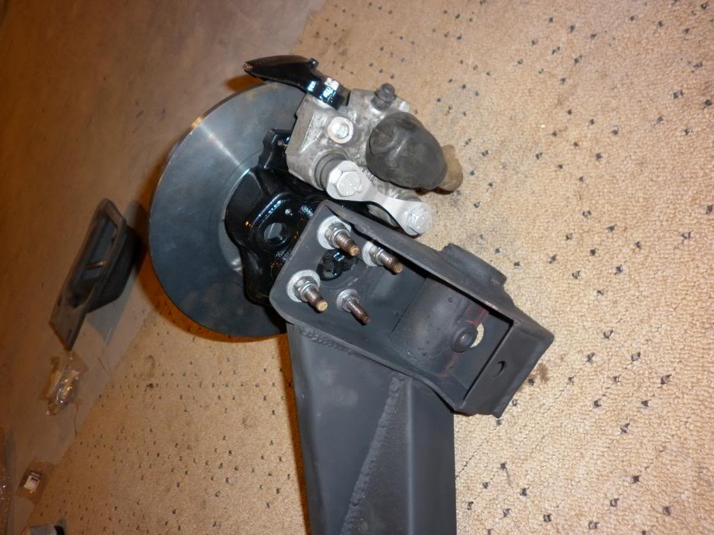

Suggestion as well for them would be to make centre hole circular rather than square, More support for the stub axle plus it mirrors the stub axle mounting face.

I think different 1*2s have different stub axle thickness. You'd be best to get under your car and measure how much of the bolts are sticking out with you current setup.

I cant get any measurements of my stub axle just now as Im miles away but I would say phase 2 172 cup stub's are almost identical to the pic on page 1 with the rear mating having a raised circular part. People with 172 cup's will be fine for bolt length with 10mm or 15mm spacers. This is my 172 cup axle and they have the thickest stub axles iirc.
Diameter of the raised circular part?

15mm spacers on FF 1*2 will be bordering on unsafe for bolt length going by Chip and Carbonraider's measurments and my picture.
