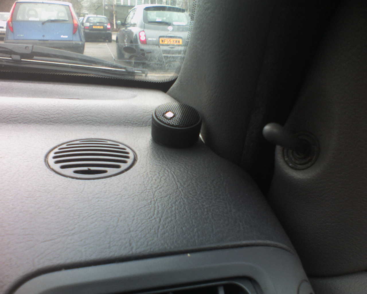

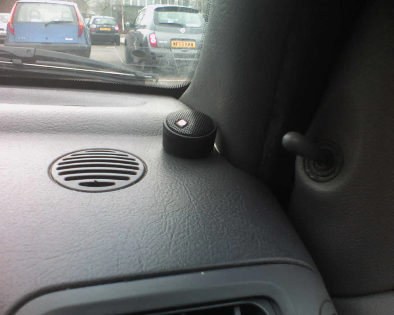

You don't need to put them in the stock loctaions, just stick them in the corner of the dash. No need to remove the dash and allows you to play with the positionings more too.

In that picture the air bag cover is still left on.
I Swear on mine its all in one and there isnt a gap between the dash and the air bag cover, it will all come off in one.
Does that make sense?
  Carrera 4S. Clio 172. M5
Trust me, its not part of the dash, it is a really good fit.
The airbag and its cover is fixed to the dash structure with 6 machine screws and the alarm modules are mounted under it.
  RenaultSport clio 172 mk2
Oh right ok if you say so, looks hard to beleive looking at it as there is no gap or cut between it and the dash but i will take your word for it.
  Mk2 172
dont put the tweeters on the top of the dash as they will sound awful and very in your face. to get the best possible sound and a decent sound stage in the front u need to position the tweeter as close to the mid range as possible.
