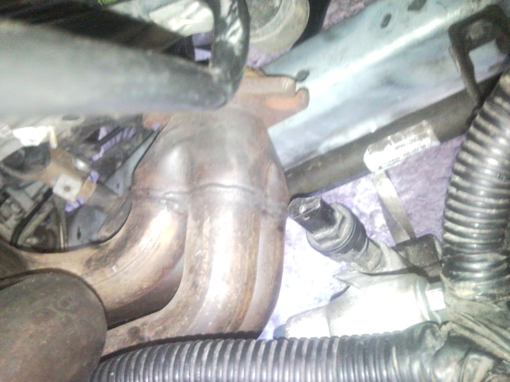

Did the original box have a sped sensor hole in it at the back of the diff?
Thats your problem if your new one dont.
Sat nav speed display or Origin B2 will do for speedo.
Is this what you mean Mike?
i take it thats the speedo connection,
Can it be easily enough just to get a different loom then it should work right?
A regular Clio gets the speedo sensor from the ABS ring. A 172 Cup gets it from the box (no ABS).
Fitting a Cup box to a 172 engine shouldn't stop the speedo working...should it??
