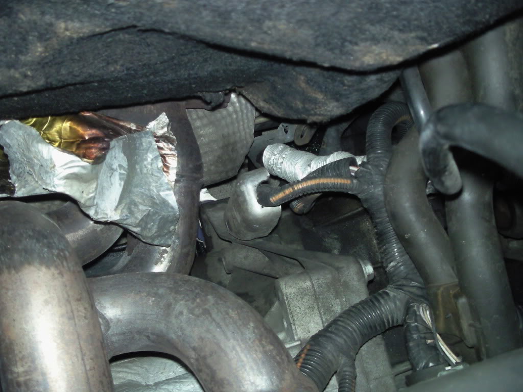

I've got the same problem on my Ph1, has anyone got a photo of sensor so I know what I'm replacing, Also exactly where it is would be good.
