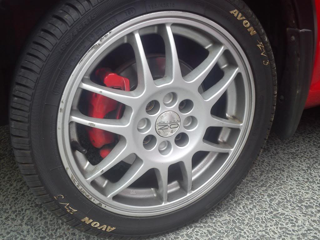

These are the rims I have.... With Renault stamped on the inside so I assume they are not aftermarket OZ F1's like you sometimes see
is it 60.1 for genuine Renault F1's and 73.1 for aftermarket OZ F1's
I am confused now :S
  182/RS2/ Turbo/Mk1
They are 60.1 for the renault ones mate, you dont even need a micrometer to check that, just put a ruler on it and you will be able to see the difference between if yours are 60.1 or 73.1
They are 38mm offset (c1 is 40 IIRC) and are 4*100 PCD
So will go on perfectly :)
