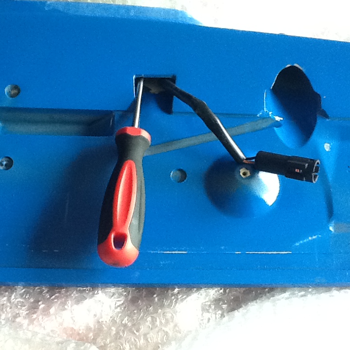

DONT prise it out from the front - 99% sure you will damage the paint or brake light will crack.
Simply turn the spoiler on its back and push a screwdriver through the hole where the brake light wiring goes through and push the light unit out - job done.
