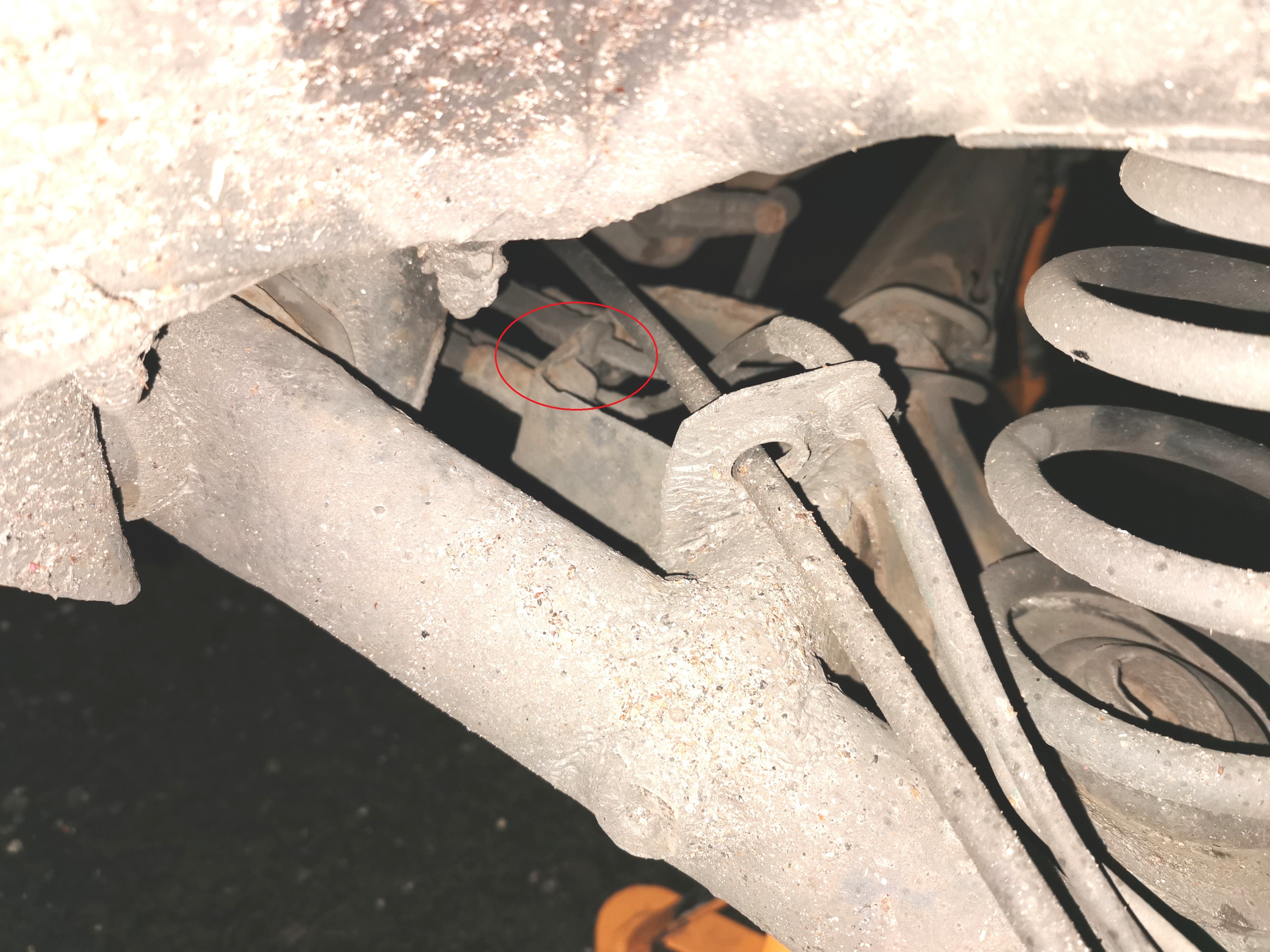

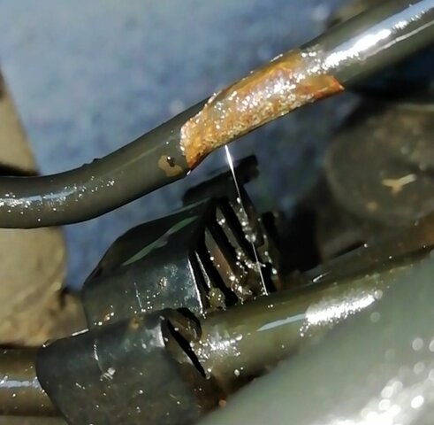

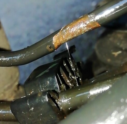

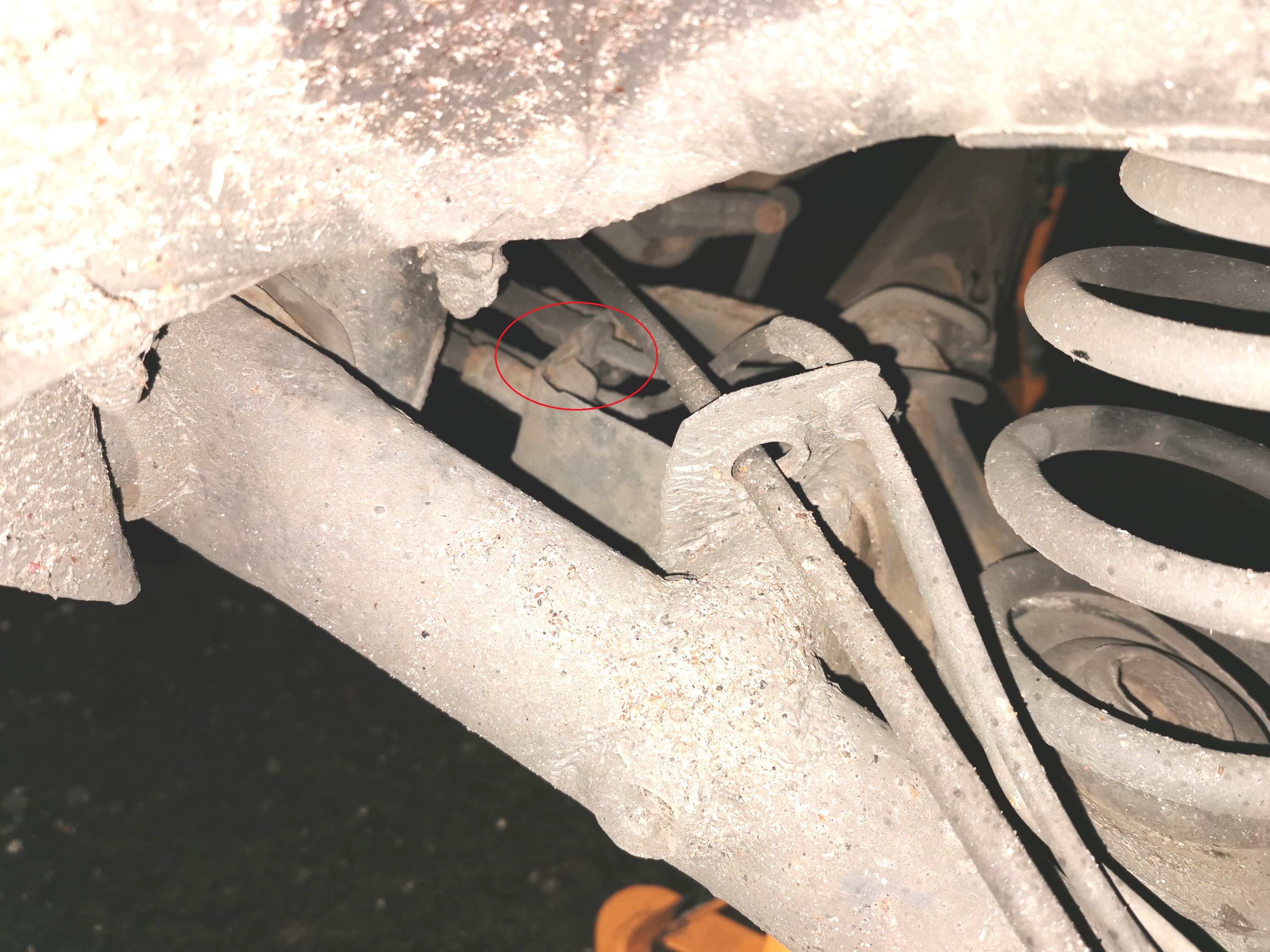

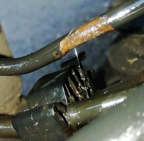

For anyone who stumbles by here in the future - just buy these. They replace the rear beam solid lines AND the stupid short flexi lines from beam to body. So straight from each caliper to body.
Length perfect, delivery next day (from memory). Made by a member on here @BRT Motorsport I believe. Job done.
As a 'by the way' type of thing I would put money on the short flexi which goes from beam to body being on its last legs, they get some good abuse over time and are constantly coated in salty mud.
