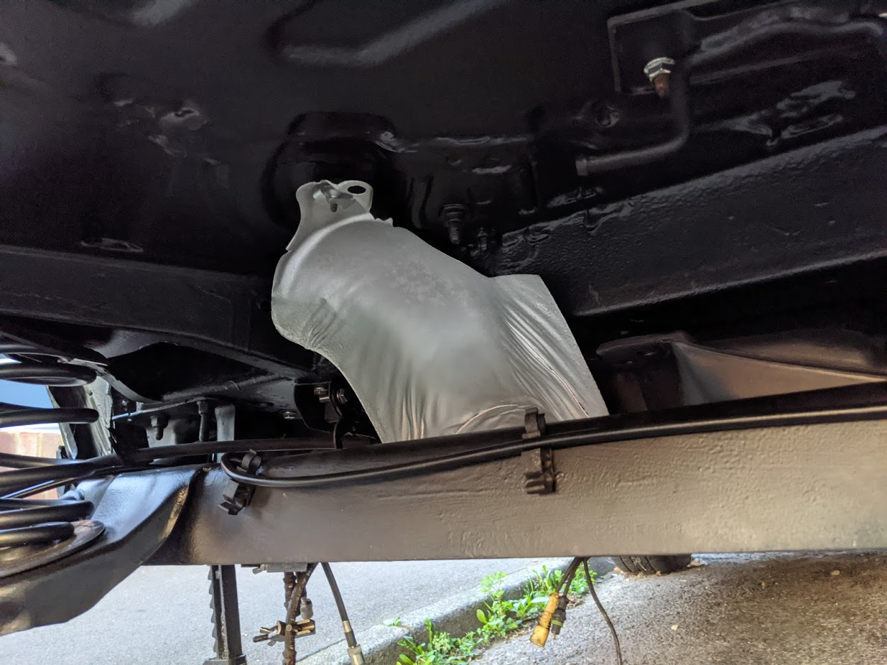

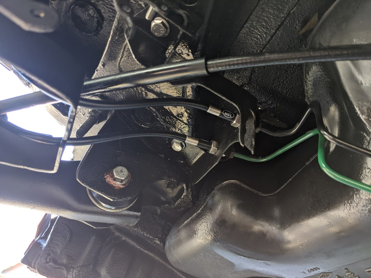

For anyone who stumbles by here in the future - just buy these. They replace the rear beam solid lines AND the stupid short flexi lines from beam to body. So straight from each caliper to body.
Length perfect, delivery next day (from memory). Made by a member on here @BRT Motorsport I believe. Job done.
As a 'by the way' type of thing I would put money on the short flexi which goes from beam to body being on its last legs, they get some good abuse over time and are constantly coated in salty mud.

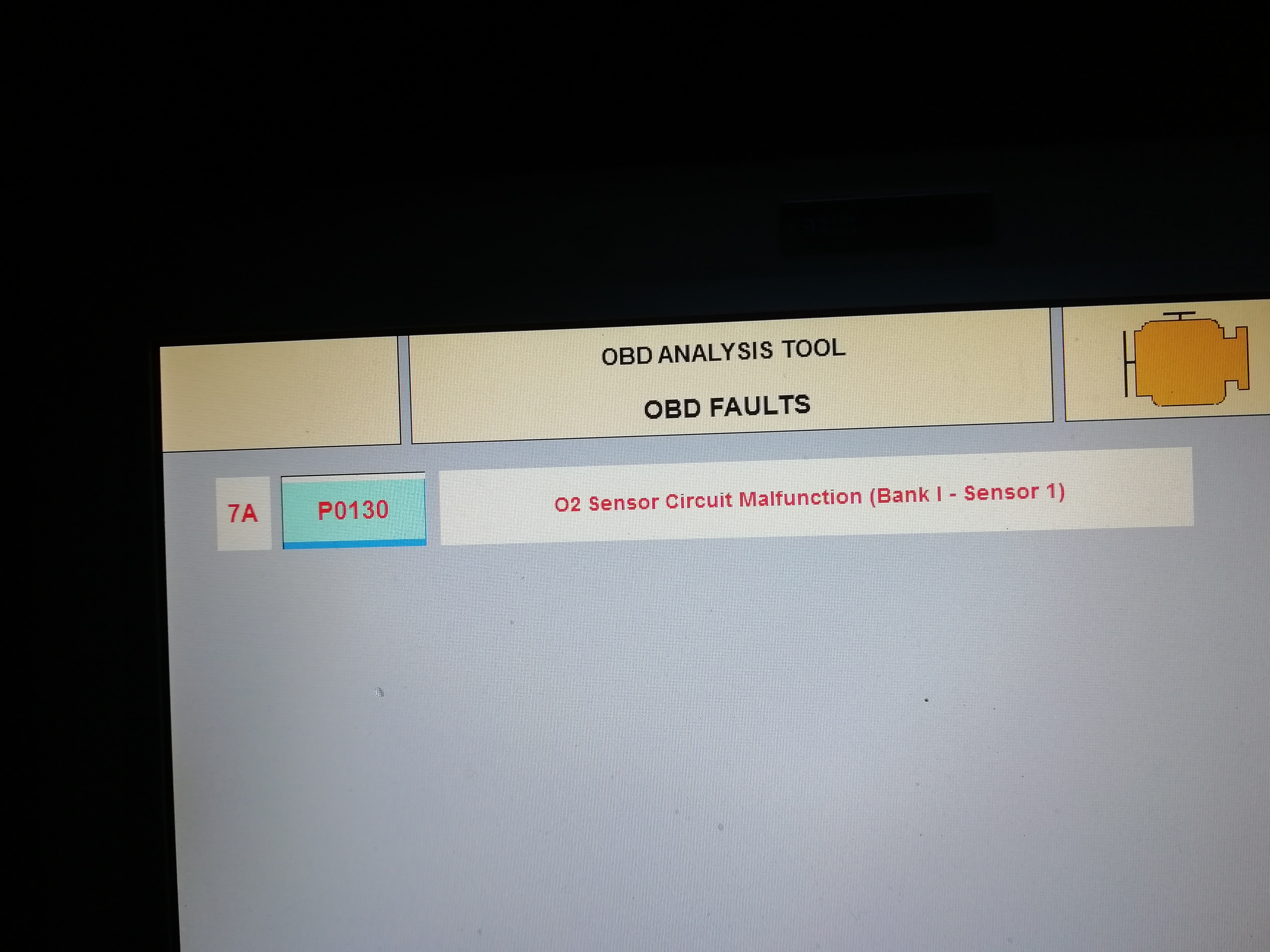

Pedal is firm now so happy But engine management light is on now wheres it wasn't before, brake fluid is above the max slightly could that cause it?
One issue after another!
Eml will be a coincidence but not related. Scan it with clip and see what codes are stored.
Here we go, cleared it and it's gone off however not sure if it will stay off.
Yeah that's not related.
Fluid fault would normally be the handbrake and stop light flickering.
Didn't think so, I did spill some brake fluid from the Reservoir and ran the engine before I noticed, maybe fried something??
I have had P0130 several times. lambda sensor if I am right. reset with my cheap code reader and a good blast and it normally doesn't come back for a while. I normally get it if I am not using the car much and just moving it in and out of the garage.
Pre-cat lambda, take it for a blast and get it hot then reset the code. My EML with a decat goes off after I rag on my 172's tits for a bit 😂
