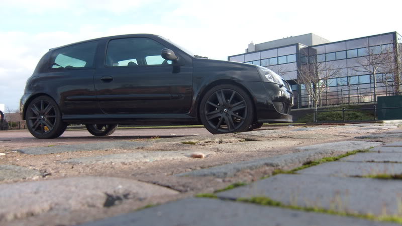

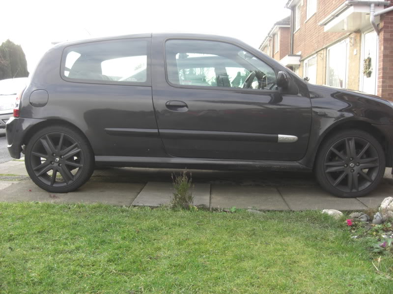

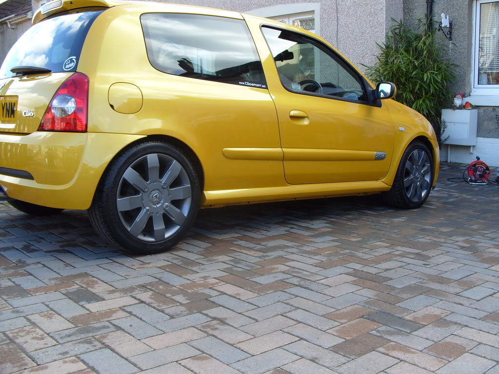

Mine is on 17" wheels;
Before (ridiculous tbh):
After:
on sportlines. They stiffen up the suspension.
