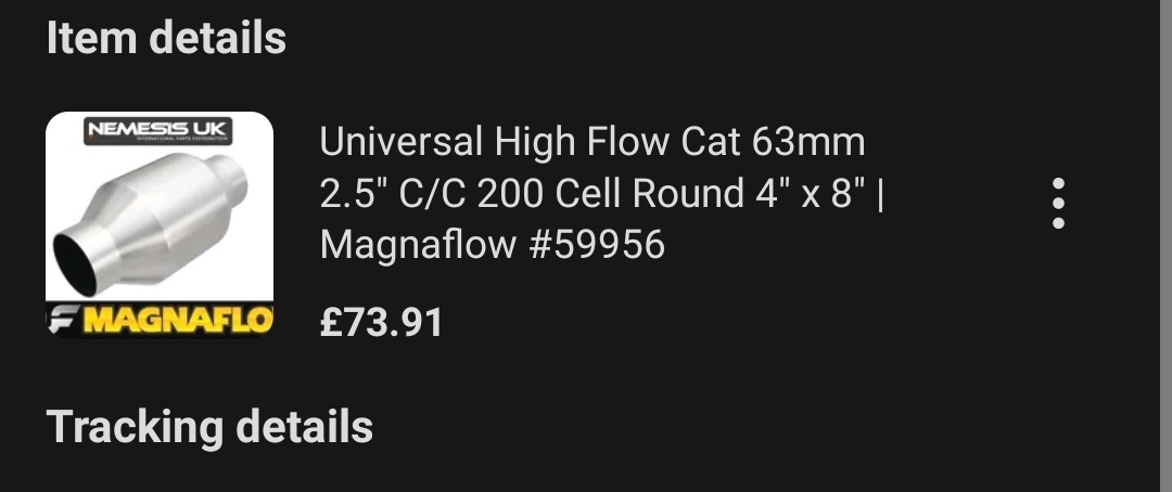

I bought a Magnaflow branded cat, as was worried about the cheaper ones not passing. I think the prices have gone up quite a bit recently, I bought mine back in November last year. Screen shot attached of the one I bought showing product number
