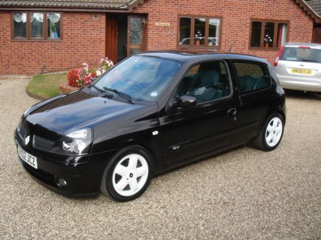

Could somebody please recommend to me a good spray paint (gloss white) for spraying front and rear diamonds and will I need to use primer?
I would like to spray my alloys white, could you recommend a spray for that and primer?
Finally, a spray for colour coding a black clio (pearl black?) for the plastic side strips, door handles etc.
If anybody has any information and could help me out with any links, I would be very happy! thanks a lot!
I am going for this look
  Punto/Clio GTT
for colour coding you need to use the colour code of the car which is on the sticker on the inside of the door appature. on mk1's its 3 numbers like 676 pearl black, dunno what it is on mk2's.
for badges, a bright white like Vauxhall Glacier White is fine and doesnt require laquer. as for the alloys, id only paint them using a spray gun with compressor, or even better have them powder coated. theres a place in birmingham that does them for £20 a whee, im sure theres a local place that would do them for that price too if you look aroundl
