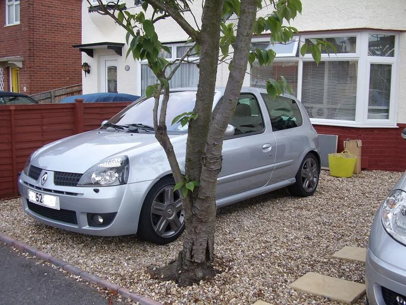

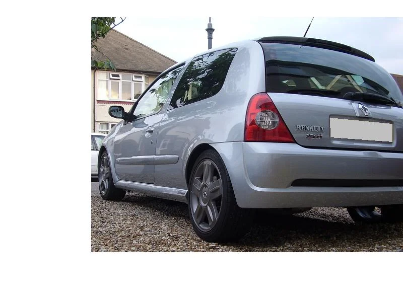

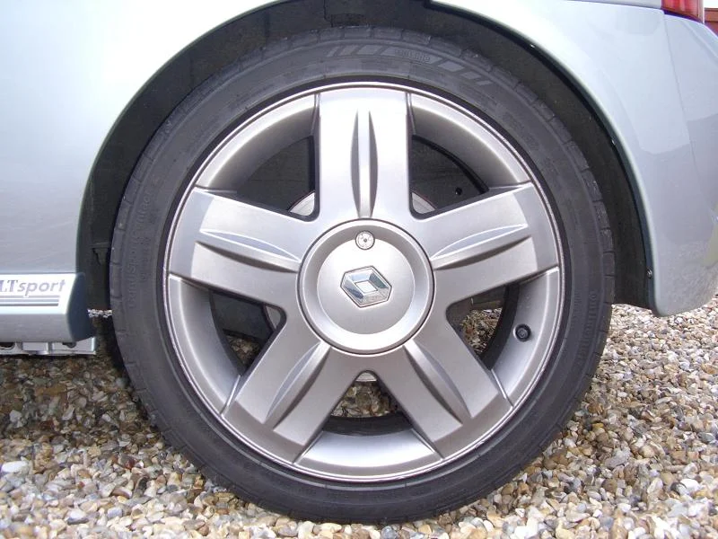

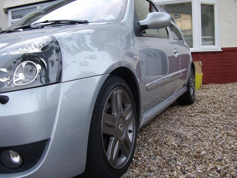

My wheels had a few small scuffs in them - (thanks to my wife!) so secided to give them a refurb...
What do you think??

cheers guys. only took half a day and 30 quid in paint. an easy job that make the car look loads better..

got the paint from halfords. its rover gun metal grey. use grey primer first. i used fine grade wet and dry to give the primer a key and to get rid of the lumps and bumps. then add a couple of coats of primer and allow to dry. flat it back and add a couple of coats of colour. i need to have a new set of tyres fitted so haven't added the clear coat yet - easier to fix if they get scratched. i masked them up with extra wide masking tape i found a b&q. its an easy job if you go slow and take your time - good luck...
