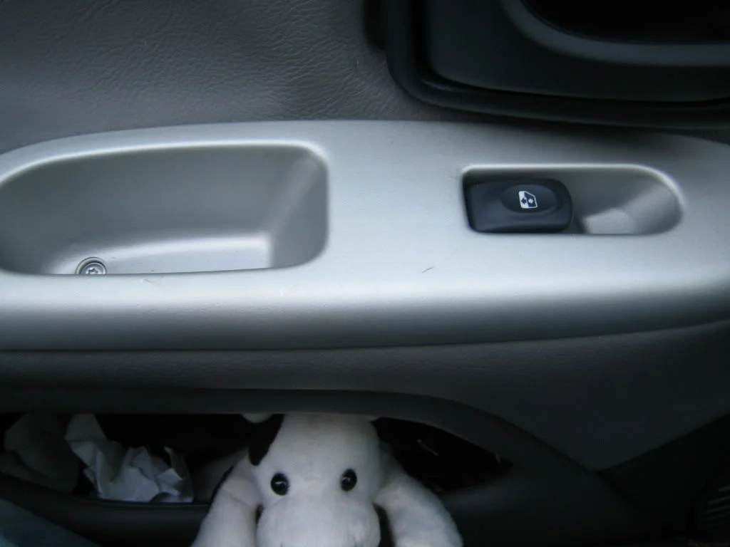

Anyone got a guide or a list of what i will need to respray these:
Pic borrowed from mitch

Na probably gonn ahve to sand it off. The peeling is why everyone replaces them, cant believe they added £60 to their cost from the dealers :(
yeah i bet them havent changed it so they dont do this anymore either, yeah i was thinking that they will need sanding down
its best to get some handles that havent been coated in the crappy rubber laquer that Renault used.
I have a set out of a basic clio here which are just black plastic, so much easier to spray.
kind off, going to sort out some sand paper, get some plastic primer and paint then experiment i guess, any more tips??

just make sure you get all that rubbery crap off before you even go near it with plastic primer. should be fine
yeah lol, i put a bit of methylated spirit on it and some of the rubbery stuff came off leaving the nice finish underneath but its going to take a whole day to get it off lol
