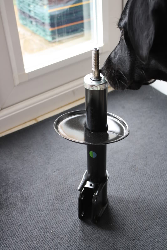

Should i have a spring cup on the strut? Just got these this morning from a member on here. When i previous replaced the springs there wasnt a rubber cup for them to sit into but now wondering if there should have been
This is a pic of the new one (ignore the dog lol)

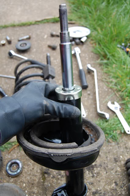

and this is a pic from the guide on here that shows the rubber cup
The new strut you have is the same shape as mine and is the correct one with no rubber cup. The old strut you have taken off is probably non OE or an older design.
Sorry for being off topic and all but your dog is Epic! Could photoshop a great caption into that pic :)
Mine didnt have the rubber base on them either when i tool them off so i am assuming it is not meant to be there....
Maybe a non sport clio or something in the pics?
