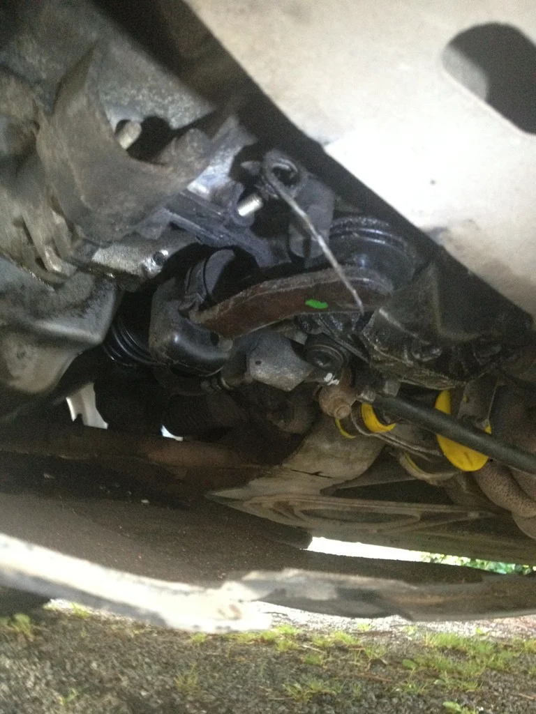

Pearce ClioSport Club Member Car 172 cup Aug 12, 2012 #1 We fitted a lower poly bushed dog bone mount an notice a spring was sheared by the gear selector what does it do ?
sven_8t4 Car Clio 172 Ph2 Aug 12, 2012 #2 If memory serves its the neutral spring so the gearstick sits between 3rd and 4th......
Pearce ClioSport Club Member Car 172 cup Aug 12, 2012 #3 sven_8t4 said: If memory serves its the neutral spring so the gearstick sits between 3rd and 4th...... Click to expand... Cheers mate but my gear stick sits between there fine
B bmh.01 Car BMW M135i Aug 13, 2012 #4 Thats what it is though, 7700110500 for a new one couple of quid.
