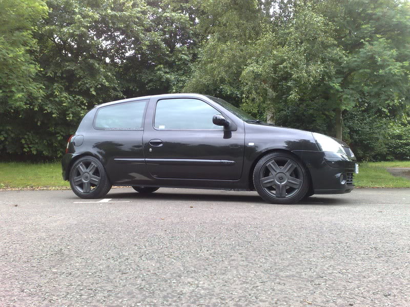

Tbh if he's not got a 1*2 then anything but cheap coilys won't fit..
I had 60mm PI springs on my 1.2 and they were real good drop..
  Astra (H) VXR
That does look a good drop.. I was assuming he would have a 1.2 or something as insurance on a 1*2 would be mental at 18.

  Clio mk2 phase 2
I like how low that clio is sitting on the 60mm springs :) i reckon ill just buy a set of 60mm springs instead of buying cheap coilovers thatll just be doing the same thing :) thanks for all the help and advice peeps :)
  Clio 172 RS2
60mm drop with standard shocks!? :nono:
