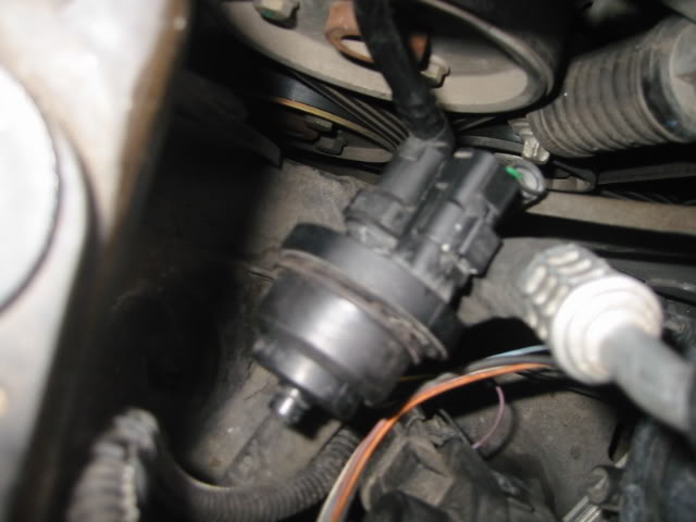

Hi, You can check the canister purge valve locate under the right lamp if this valve is dirty inside or damaged can cause stall at idle

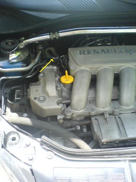

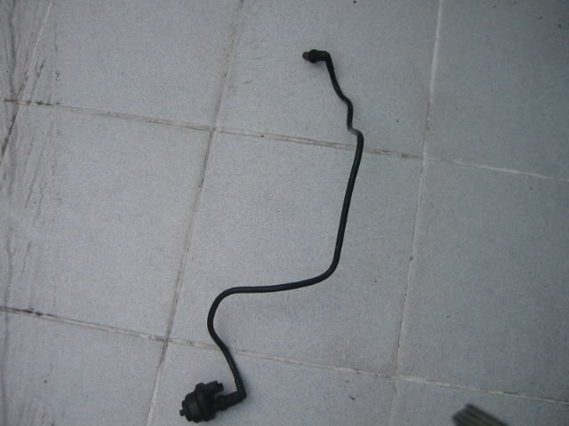

You can remove it and clean it with carburator cleaner, be patient to put in the valve again, if you remove the bumber and lamp is much easier

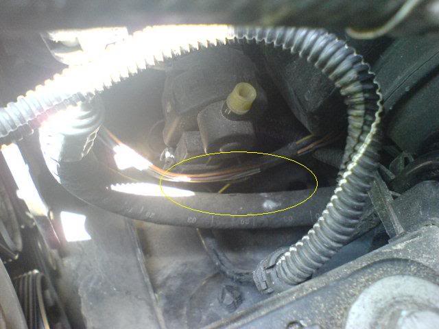

But because Ive got a race engine they've bloomin drilled a hole in my plenum and fitted the vapour line into it :S
Also looks like that gold bit is missing
