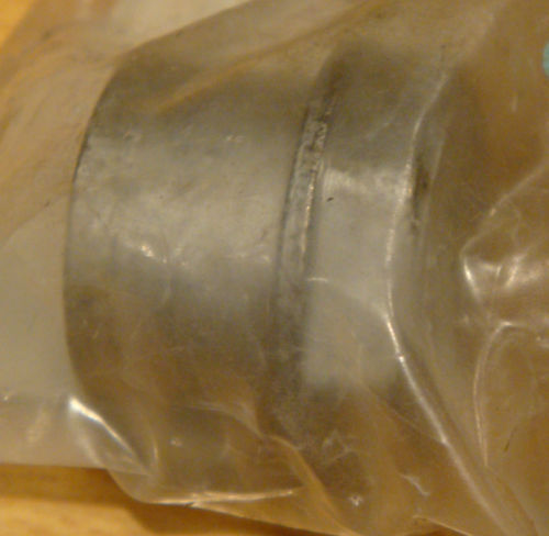

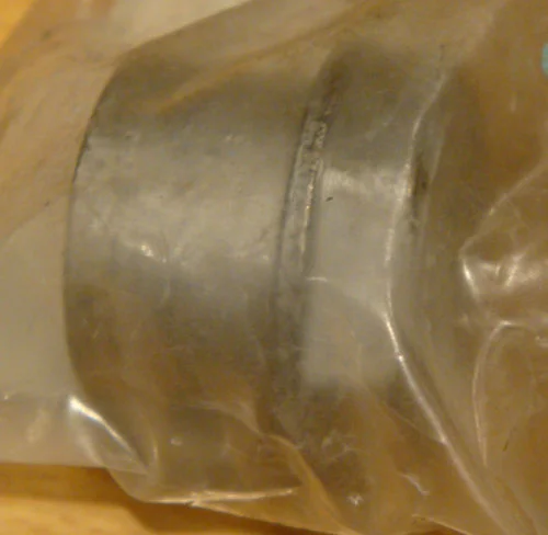

If you bought kits with part number 543A09780R, you need the replacement for the spacer & 17mm nut, which is part number 8200867250.See the picture in this attachment.
http://www.renaultpartsdirect.co.uk...shock-absorber-top-mount-kit-with-spacer-nut/
In the past, these have been manufactured with too many threads, and would become thread bound before seating on the bearing.
Recently, it would appear that they have been modified and now fit correctly, but I would still recommend you pre-assemble and inspect before fit them on the car, in case you get supplied with the old stock.
If you compare the top caps, (the round discs you can see on top of the turrets in the engine bay), they are quite different, where the old design would sit over the 17mm nut, and the new design is flat bottomed, and sits on the 27mm nut / spacer I have given you the part number for.
Hope this helps.

The modified 27mm nut 8200867250 replaces the old spacer & 17mm nut, and holds the strut/spring assembly as it always did.

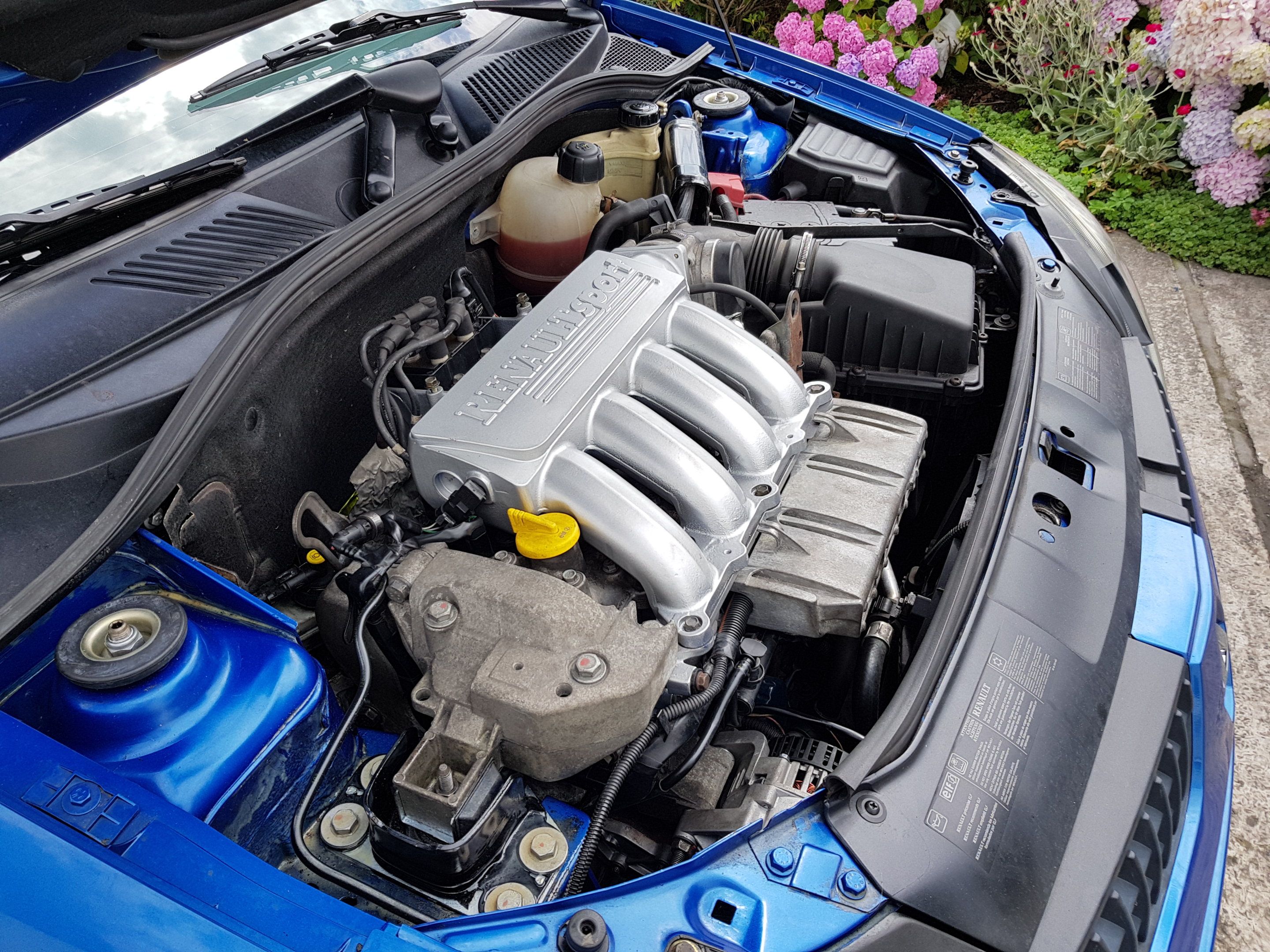

The top cap in the engine bay has a flat bottom, & sits on top of 27mm nut, & is retained by a 21mm nut that comes with the new kit.

You cannot use the old style top cap with the integral 21mm nut, as it is taller due to the fact that it used to fit over the 17mm nut.
If you need to replace the top mounts, it`s cheaper & easier to use the Febi ones Mark mentioned in post 17, from eBay.

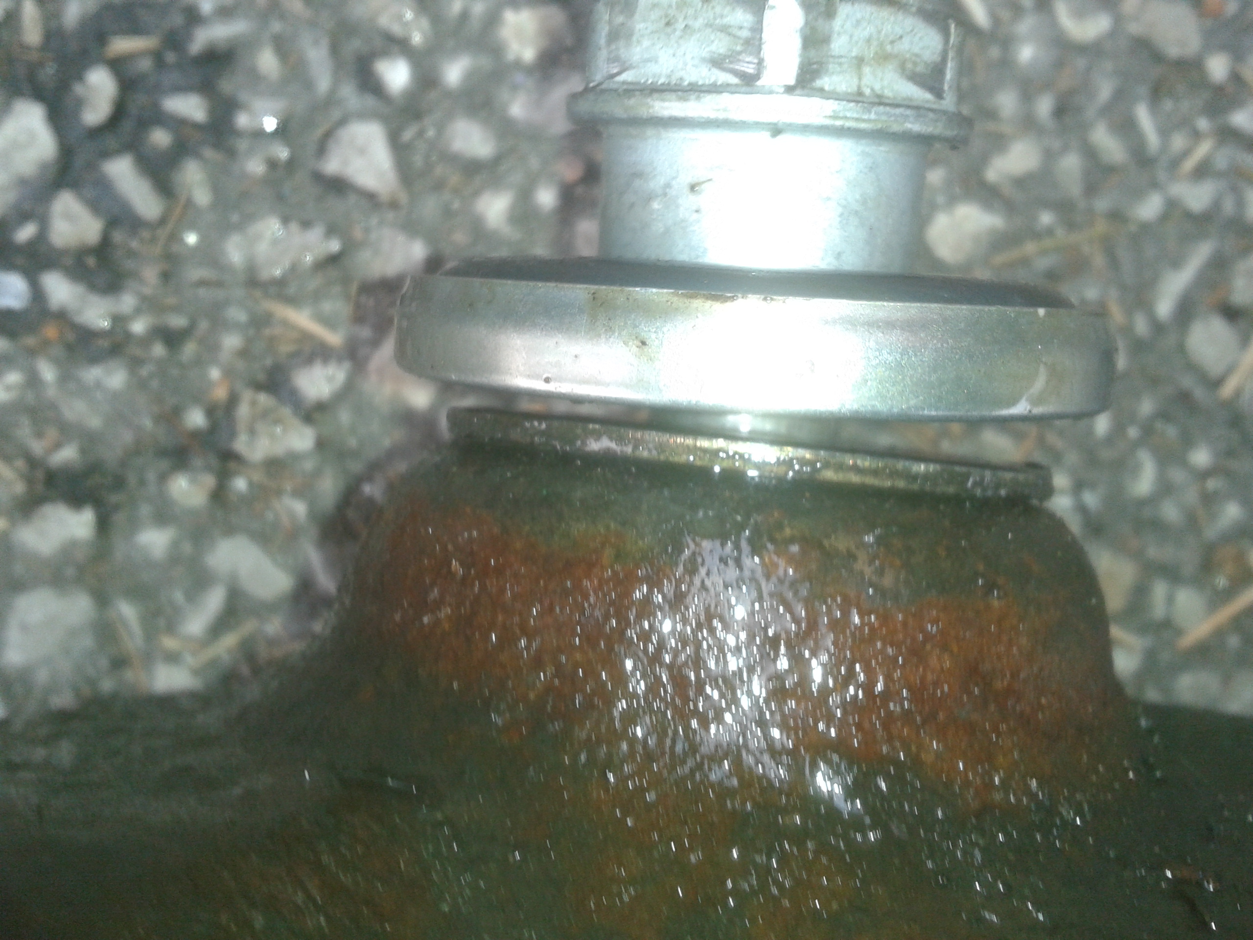

The fact that the OP mentioned problems with play, makes me suspect there are still some of new type with too many threads floating about.
You can see here that it becomes threadbound before it makes contact with the bearing.

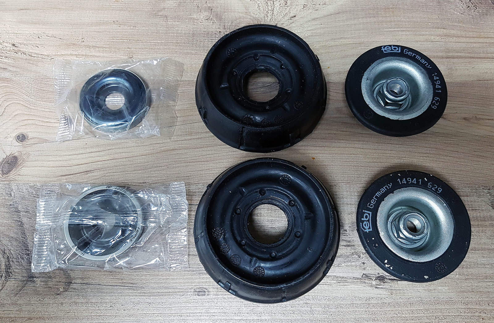

Are the febi ones designed to work with the old style 17mm and spacer or the new style spacer nut? As it doesn't look as though they come with the spacer from the pic
I'm having the same issue. New style top mount, I'm on my second new style nut, but it's still threadbound. I can't seem to find one of the updated new style nut anywhere. I've emailed a couple of companies but no-one seems to get back to me.
Any ideas? I'm £35 down already.

Run a 14mm drill down it to leave the same amount of threads as are on the original 17mm nut.

i get them from local factors i've been using for about 30 years. you can get them on ebay easy enough. i normally use febi for mounts etc but kyb make the dampers for the sport and they had them in stock so went for them instead of ordering the febi.
Does anybody have a link for the correct 182 Febi full top mounts kit?
