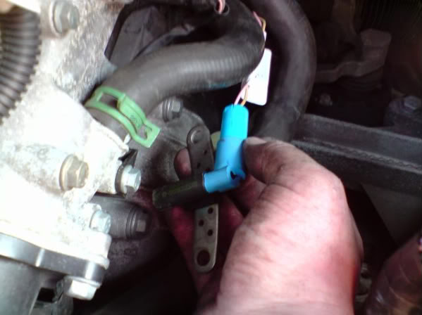

TDC Sensor on top of the gearbox.
Loses connection and it just clicks with no start. It's often on the plug/loom rather then the sensor.
I've read the sensor is in the same place as the manual, so the above image should help.
