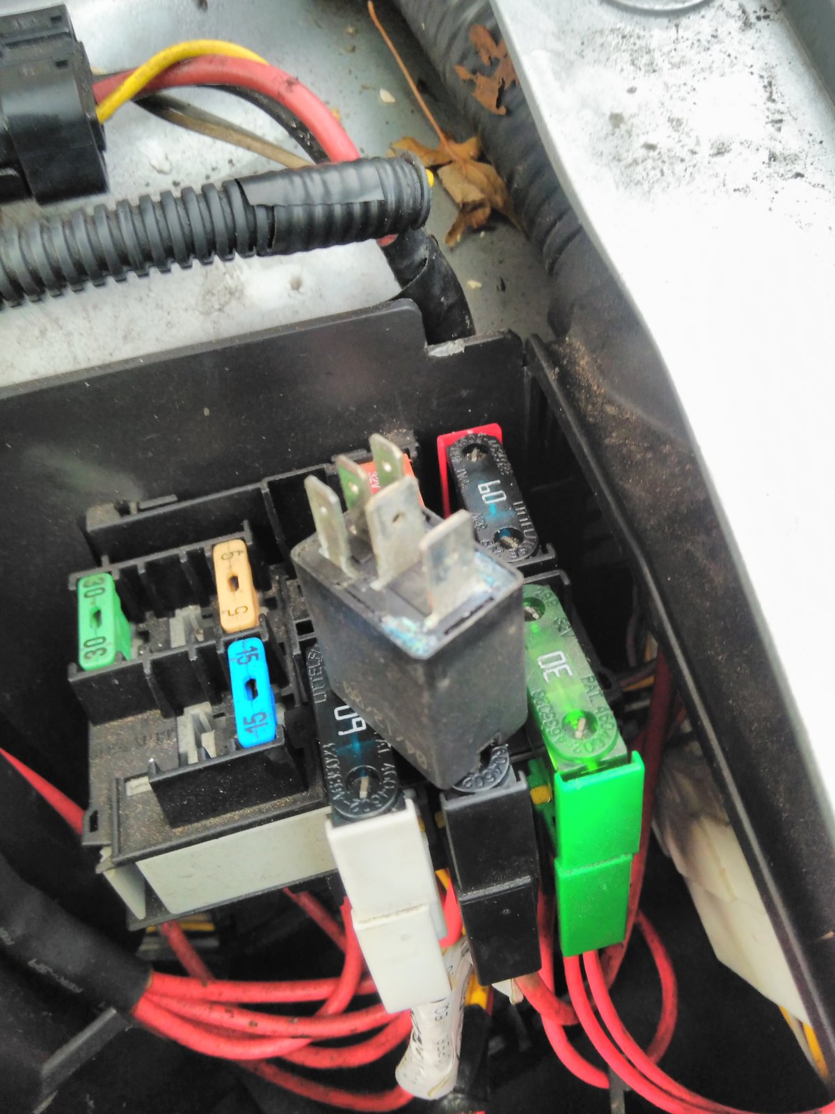

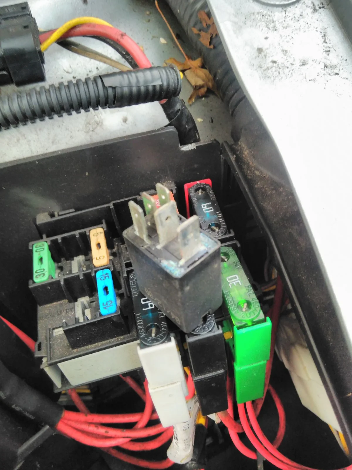

So I'm currently poking around the 3 black relays again in the bay, does this relay look goosed to anyone else.? Blue/green copper deposits im thinking.?
I've swapped all three around with no success in starting. I've now got the battery light on from many starting attempts, so I've disconnected that before it's flat as a pancake...

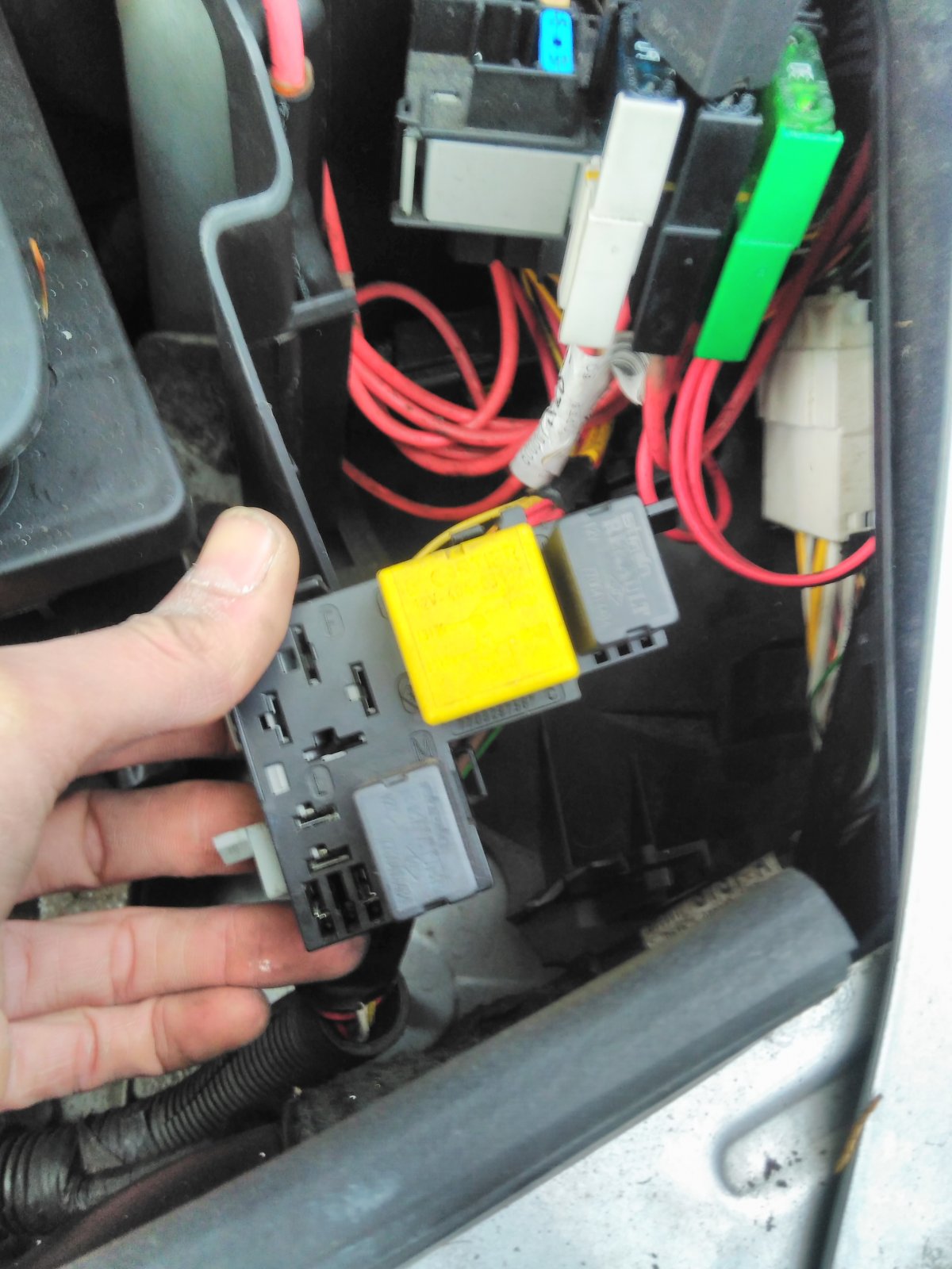

Relay box for reference.

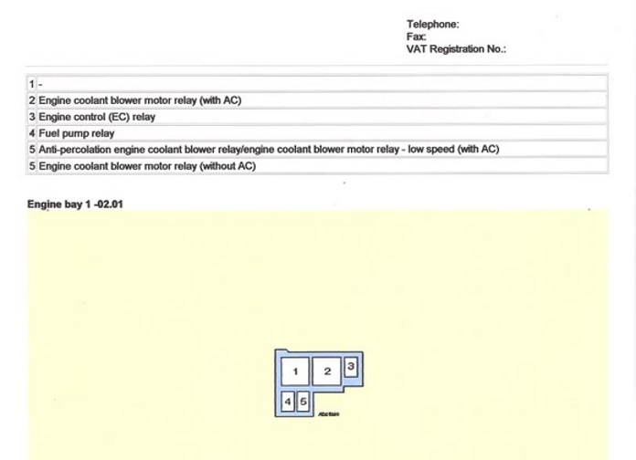

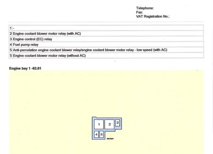

I've done some digging into a relay box diagram. The relay I posted a pic of seems to be for the fuel pump, which despite looking suspect I've definitely heard it priming as I got on my belly and turned the key over to check, so must be working and just looking aged...
