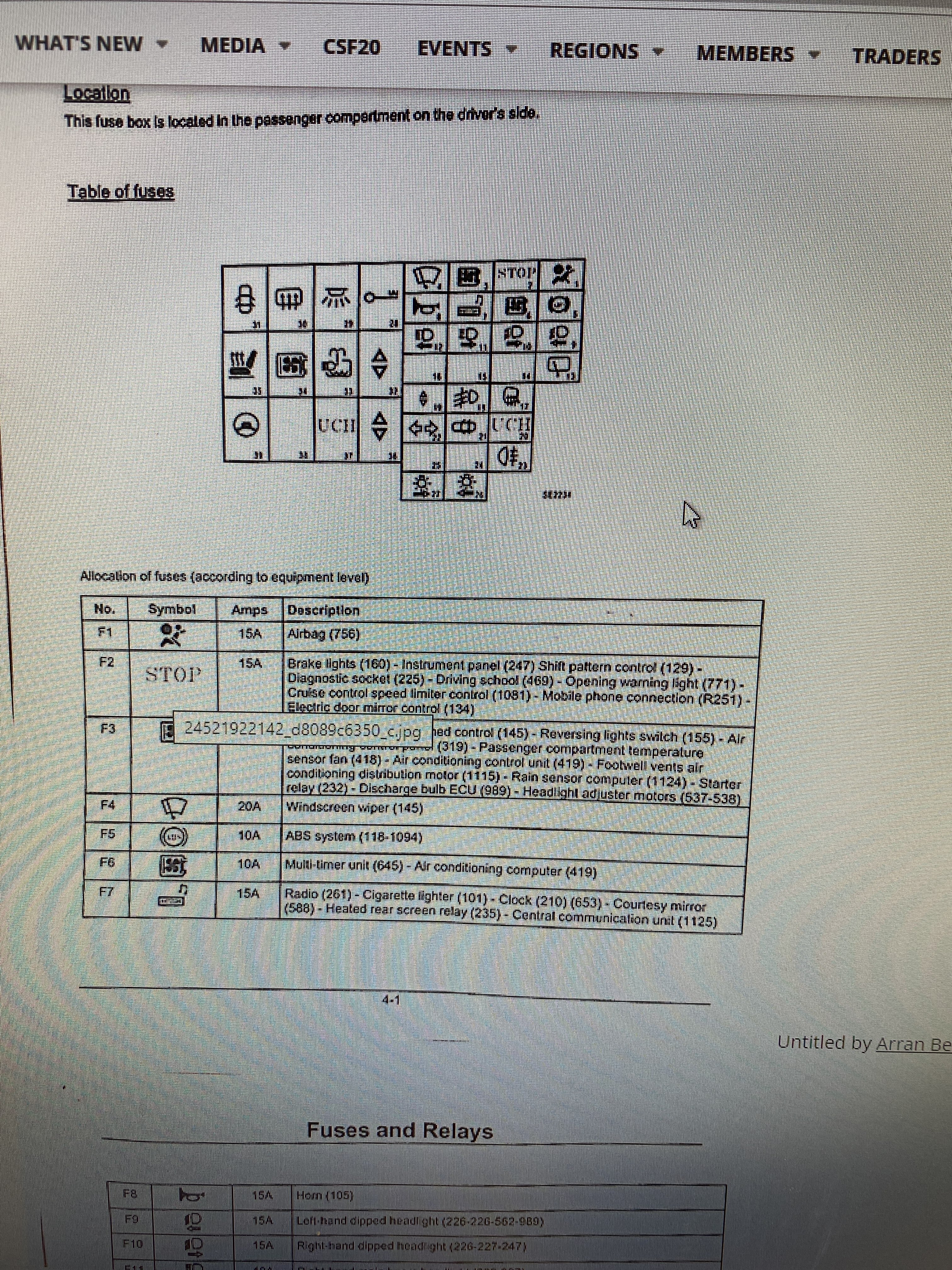

When you say the stop fuse I assume you mean f2 in this pic?
