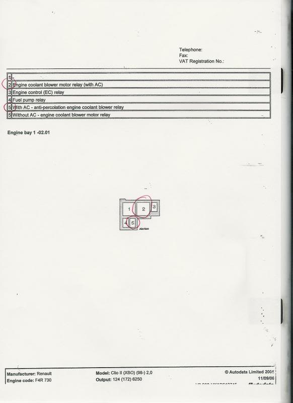

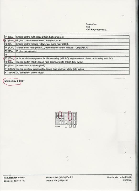

O/T Don't suppose you've got a legend which relay and fuse does what in the engine fuse box do you Brian? I can't find anything anywhere.
Yes, hold on Ill upload it for you !

Cheers bud :)
There you go !
