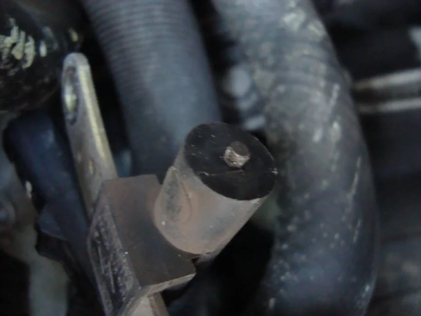

OK so I've had the airbox out and the TDC sensor out - does this look dirty? It's the original one (black connections)
Also battery seems to be OK: 12.6V at rest, even though it is also the original from 2003!

  Iceberg 172
Anyone? This look dirty?
Not had the starting problem since I had this out on Friday so I may have sorted it?! :cool:
  Megane dci 130
Get the modified crank sensor and loom on there, You wont see anything wrong with the cranksensor its self.
