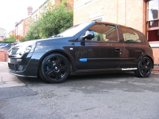

As a few of you know I recently bought a 172 phase two and have set about doing a few 'upgrades' to it. The first two things were the suspension and exhaust system. A few PPl wanted me to do a little review of these and I was planning on posting a few vid clips but the car is covered in 4 inches of snow at the moment! Anyway, here's a few pics and comments for the time being, I'll pop some sound clips up later;) !

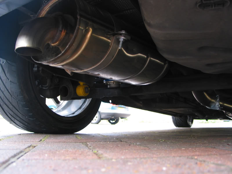

K-Tec stealth mk2 with sports cat:
When I got the car off of Danny the cat had completely broken and the back-box was a bit of a nasty twin 3" job anyway so I went on the look-out for a new complete system. Having looked at a few options I decided that the only tail-pipe I liked on the clio was the 182 style twin exit style and although k-tec do one of these for the 172, I didn't really think it was 'right' to try and make my 172 look like a 182!
After having a chat with the guys at k-tec my mind was made up and I went for a mk2 steath system. The new system is increased diameter (now 2.5") and has been developed to be quiet at cruising speed but 'rorty' when you put you foot down. The sports cat looked a nice piece of kit and was only £300 so worked out cheaper than a new cat from Renault.
When the system arrived I was pleased to see that there was a lot of adjustablilty built In and all of the hangers were able to be moved, the build quality was fantasitc too. I dropped it off at my local garage and they popped it on for me, commenting that is was 'a joy to fit'. Brilliant!
First imressions were great. The exhaust sounded awsome under full boot and gave the car a real 'race-car' like sound, even better than any group 'n' exhausts I've had on previous cars. It didn't look chavvy either with the zorst tucked under the bumper! I later drove over to try my Dad's house to try his standard 172. The gains from the zorst/cat were very apparent! There was noticably more pull from low-down and my car felt noticably more lively and responsive, It made a way way better sound too:D
After establishing that there was a difference in performance and noise, I was interested in what it would be like on the motorway. I'm pleased to report that it's perfectly liveable and not very intrusive at all when cruising at 80ish, mind you I used to do that trip in an S1 Elise:eek:
The only downside so far is the rattle. I took the car back to the garage who fitted it yesterday and they thought I would be a straight-forward 'tweak'. It turns out that the middle box is rattling internally! I rang K-tec and this is the 2nd one they've had do this and they've discovered what the problem is. The two skins on the centre box are a bit too close together and when the exhaust get hot the catch on each other. They are addressed this and the new batch with not suffer this problem. To give them credit they were very helpful and have send me a new centre box out under warrenty! We'll see if this one does the same!!

When they arrived I had them fitted straight on and set up roughly by my local garage. The ride height was set as low as it could go at the back and the front was set to match! This resulted in lots of scraping on inclines and weels hitting arch liners over bumpy b-roads, I then raised it to the height shown below(sorry, rubbish photo):
This looked cool but I still had a problem with bumpy b-roads and scraping, along with not being able to get over speed bumps. I decided to raise it up to about an overall drop of appox -40mm. This made a huge difference. The car could be driven over un-even surfaces fast without any scraping and has meant it's perfectly practical where-ever I drive, even over those silly island speed bumps!! This is the height now:
The handling is vastly improved over the 70k standard dampers and Apex springs. The Apex's make the FK's feel like rolls royce suspension over bumps!!! Compared to standard springs and dampers the FKs are firmer but nowhere near as bad as I was lead to belive. Slow speed ride is even (dare I say) supple! There is way way more body control with hardly any roll! The only downside is the lack of travel compared to the standard set-up. This is just the nature of the product really and not an FK specific issue, I'm sure I'd find the same with H+R's or Billies! When pushing really hard on a really lumpy B-road section, a well set-up standard car would probably have the edge, but most of the time the FK's are well under control! I am geeting more used to the car though and the more I drive it the more I'm Impressed by the FK's, They really were a bargain. I was meant to go to Powerstation today and have a 4 wheel alignment and camber set-up done but the snow has stopped that, I'll report on the changes that makes!

Just a quick update on the Stealth system. As I mentioned above it has been making a really annoying rattle ever since I fitted it. This was due to a faulty centre box. True to their word, K-tec sent a new section out asap. I took it up to my local friendly garage and half and hour later the new box was on. When the car was fired up, the problem was the same! :mad: :mad: New section, same rattle, albiet not quite as bad! It's really starting to wind me up now. It cost me another 30mins labour to have it fitted and put the garage out a fair bit as they fitted it on the spot for me! I rang K-tec and they said they're getting a new 'revised' batch in on monday so all I can do is wait for them to arrive and hope the problem is sorted! Oh well, at least K-tec are happy to sort the problem out;)
