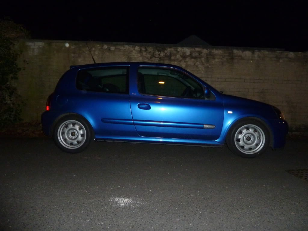

15" steelies off a clio 16v or williams fit. i run them in the winter, look s**t on this pic, but same as the williams wheels on clio 172/182's look very good in the flesh, i love em, going to get them refurbed and looking tidy!
