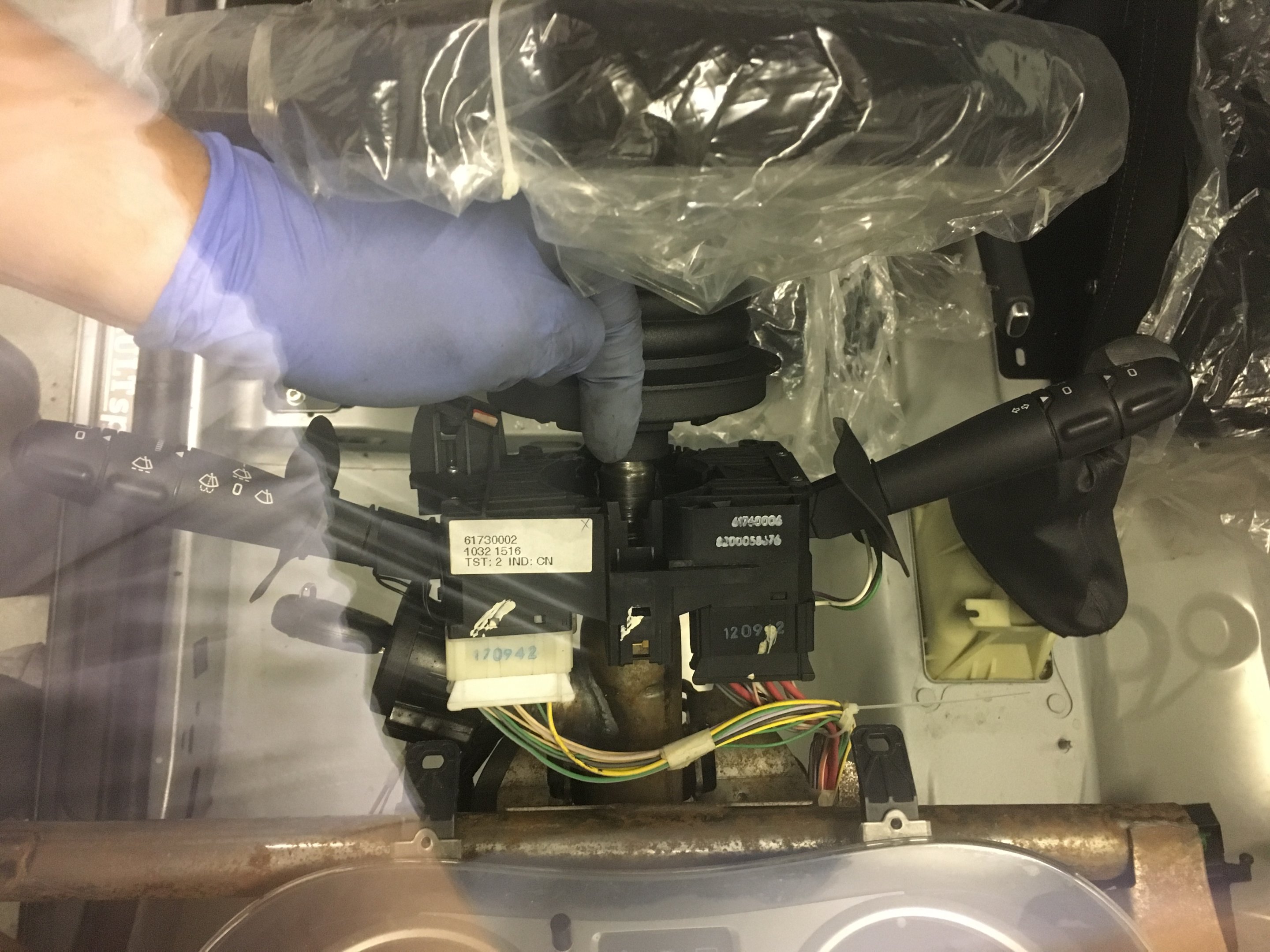

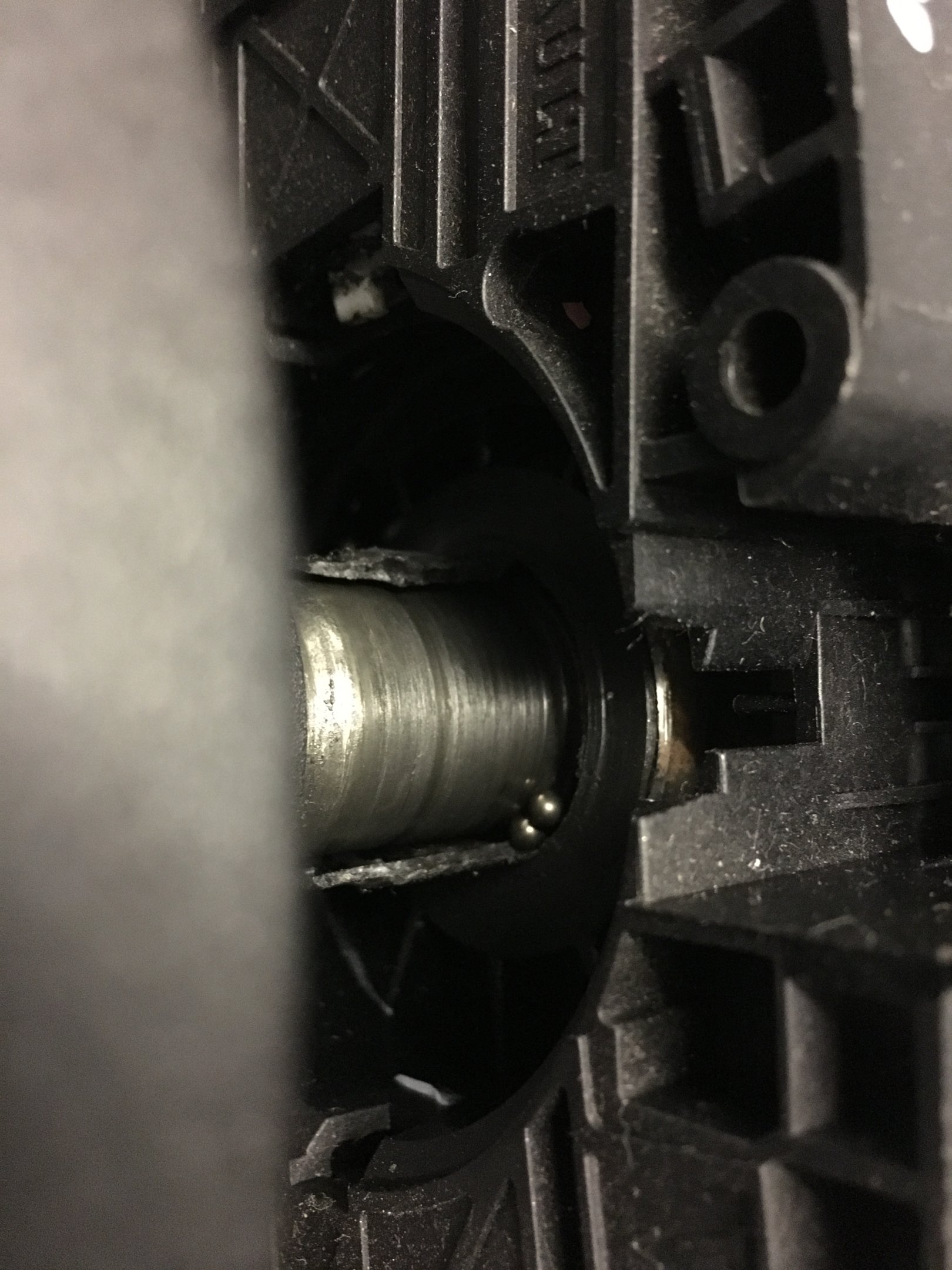

I've got play in my steering wheel, mostly up and down and it's quite bad.
I can see that there are ball bearings missing on the column which are about 2/3mm thick, these are what's causing the play on the column itself I believe.
You can see the area I mean by looking at the pictures below
My questions are..
Has the black outer case on the column broken or got a part missing
How do I go about fixing this?
New column?
If I need a new column, what needs replacing and what part numbers etc.
Thanks all

It looks like it`s not serviceable.
Try @Kelv for a replacement.
https://partsouq.com/en/catalog/gen...E01XRCtV$&vid=1247&cid=2041763634&uid=3334&q=
Hi Steve, what is it about my steering column that isn't serviceable? Just so I know what I'm looking for if I go to a scrappy if @Kelv hasnt got one for me.
Thanks for your reply
Renault don`t supply any parts, just the unit.
Someone on here will have one.
