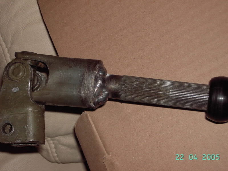

Also check your steering column though. At the base of the column just ehind the pedals there is a black rubber gaitor, lift that up and you will see a universal joint where the column joins with the rack. Turn the steering wheel and see if there is any play there first. Its a common fault and you can either get it welded up cheaply or bung a new column in.
How do I go about getting it welded and what am I lookin for?? How much would a new part be??
You could take it to a garage to get it welded, but you might have trouble with finding someone willing to weld it in situ as its in a fairly awkward place and the risk of setting fire to your carpet is relatively high.
That is the bit that needs welding.
