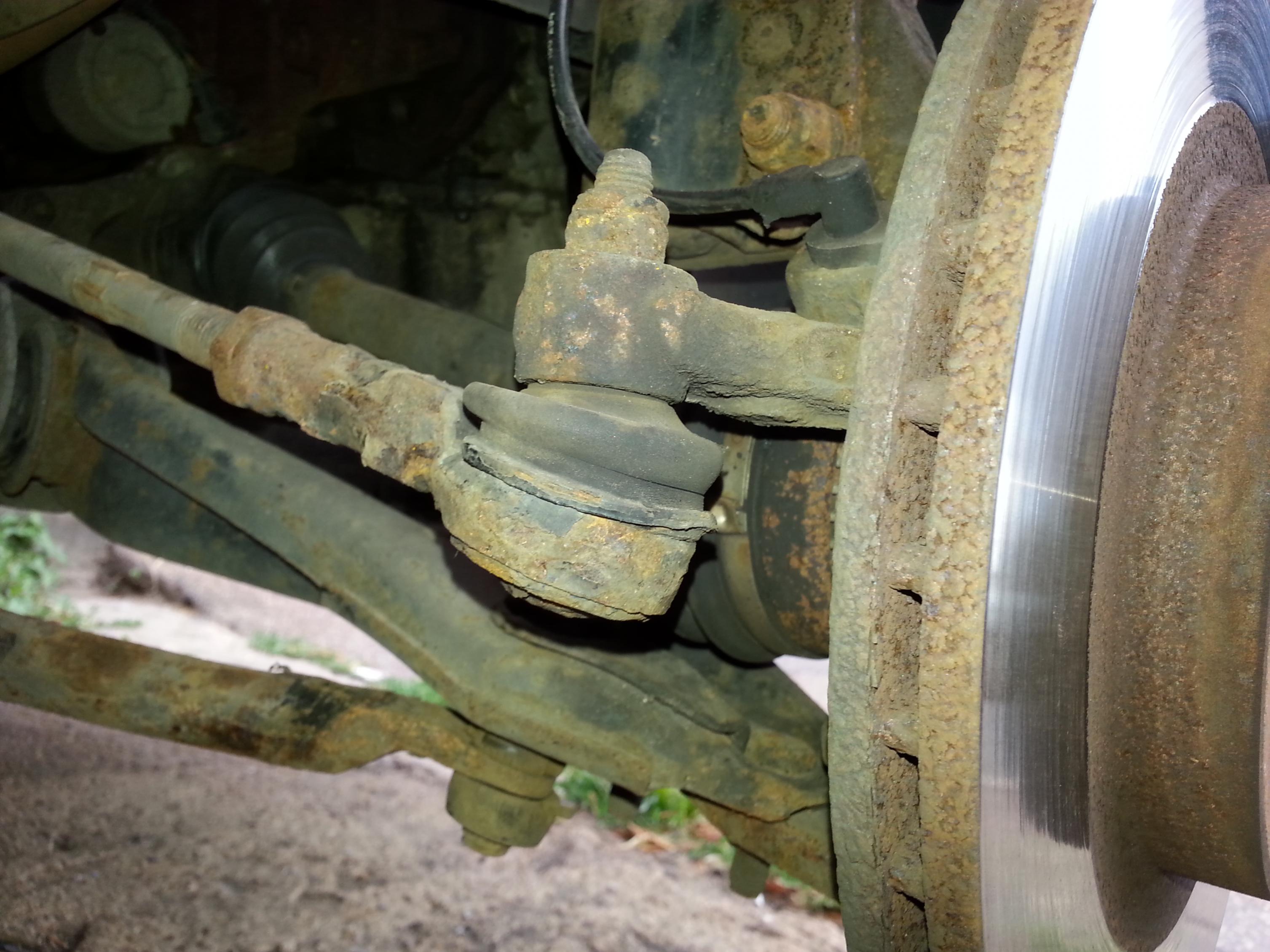

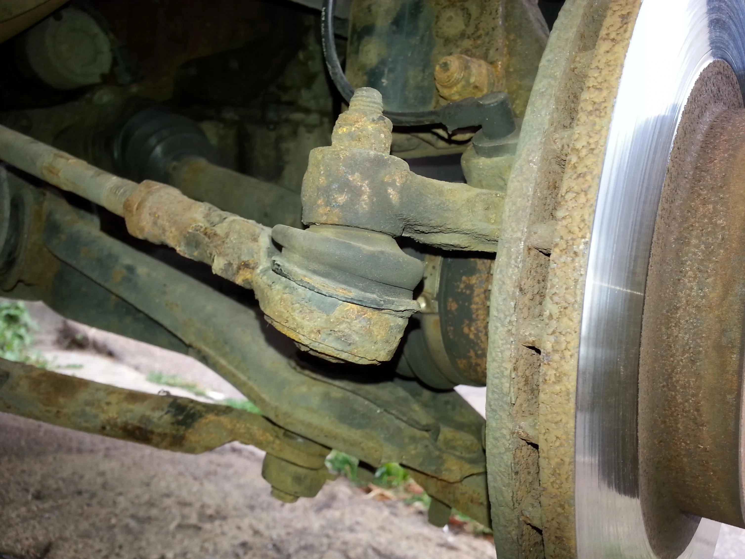

been to 3 garages so far, none could find a problem. so i decided to jack the car up today and found this has a lot of play in its balljoint
am i correct in thinking it is the trackrod end? and if so im guessing this is the culprit!?
  16v 1.6 Clio MK3 GT
i gave this another closer inspection the otherday and now im not so sure after seeing a vid on youtube. i tried moving the hub by holding the disc and there was no movement whatsoever left right up or down. and no visible movement on the joint area.
thing is when i grab the tie rod i can rotate it a bit, but i cant on the otherside of the car its stiffer. im guessing thats just normal since the otherside does too?
