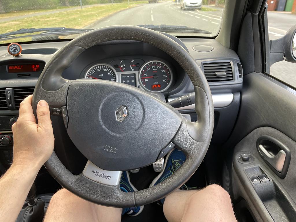

My Clio 182 recently passed its MOT (and trying to sell it) but I went out for a drive to keep the battery topped up and suddenly noticed the steering wheel wasn't straight as I was driving. It's turned to the right when I'm driving straight. When I turn left it seems to correct itself and then when I turn the wheel to the right it doesn't correct itself but I'm still driving straight.
I had two new tyres fitted after this, and they did the alignment three times but it didn't fix it. They have no idea. They had a quick look at the suspension and couldn't see any issues.
I'm not handy but any suggestions to take to a mechanic?

So if you turn left and then straighten out the steeing wheel is level but if you turn right and then straighten out its cocked over to the right?
If its not the alignment im pretty sure theres a steering rack bush that makes the steering wheel flop around like this.
They drive like a sack of s**t when the rack bushes are gone, super dangerous feeling. If it was fine before... and now its not I would suggest the track rod has been bent or as dave has said a rack bush is gone so the rack is moving about.
If you're having to suggest that to the garage, I'd second taking it somewhere else than the place that did the alignment and were stumped by the results.

Check for play in the steering,, while wheel raised get someone to rock the steering wheel while you hold the tyre left and right, If there is play you'll feel it - there should be none,(or maybe a very very tiny amount (if you feel any then bushes or a track rod is most likely culprit.
