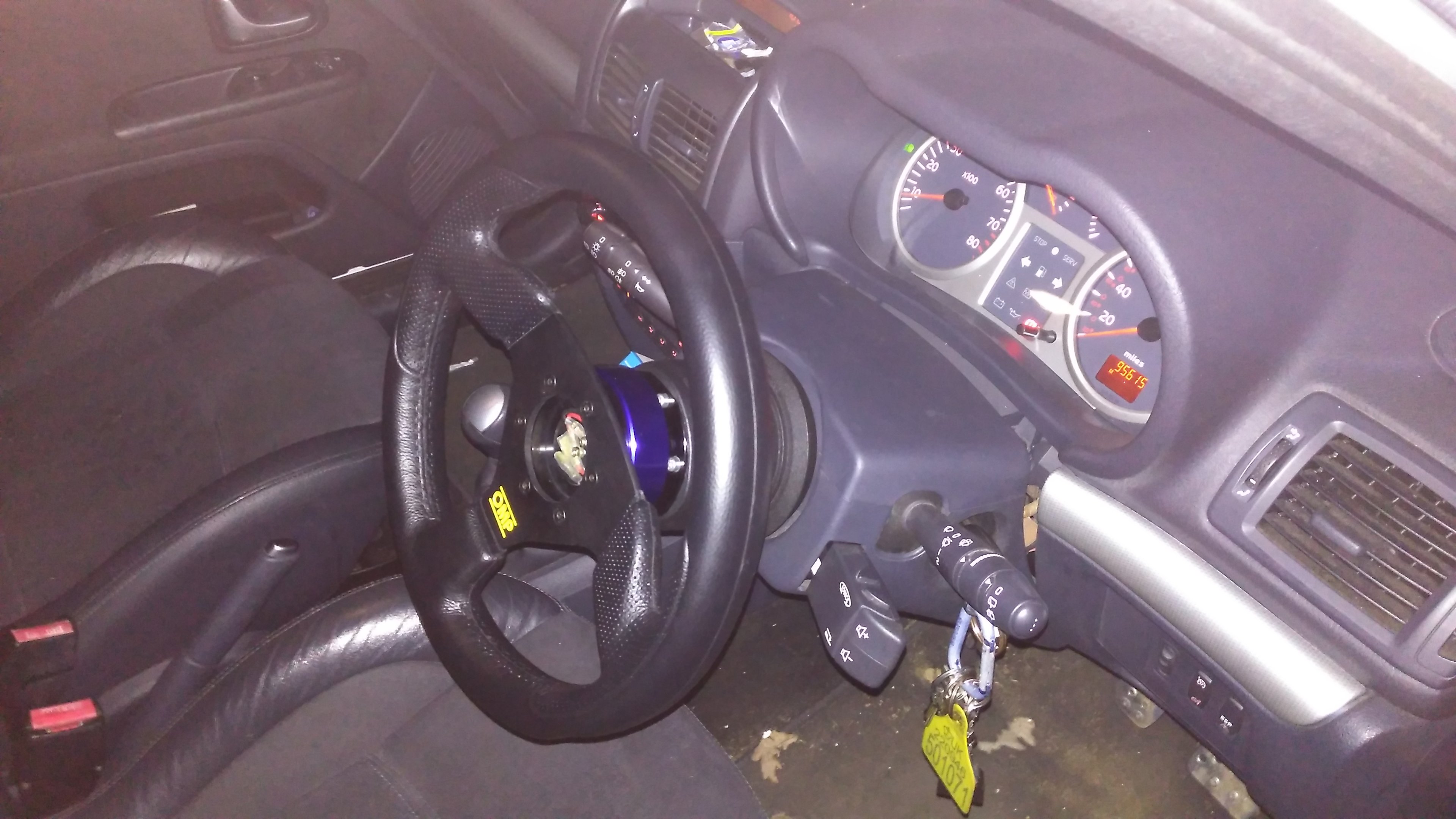

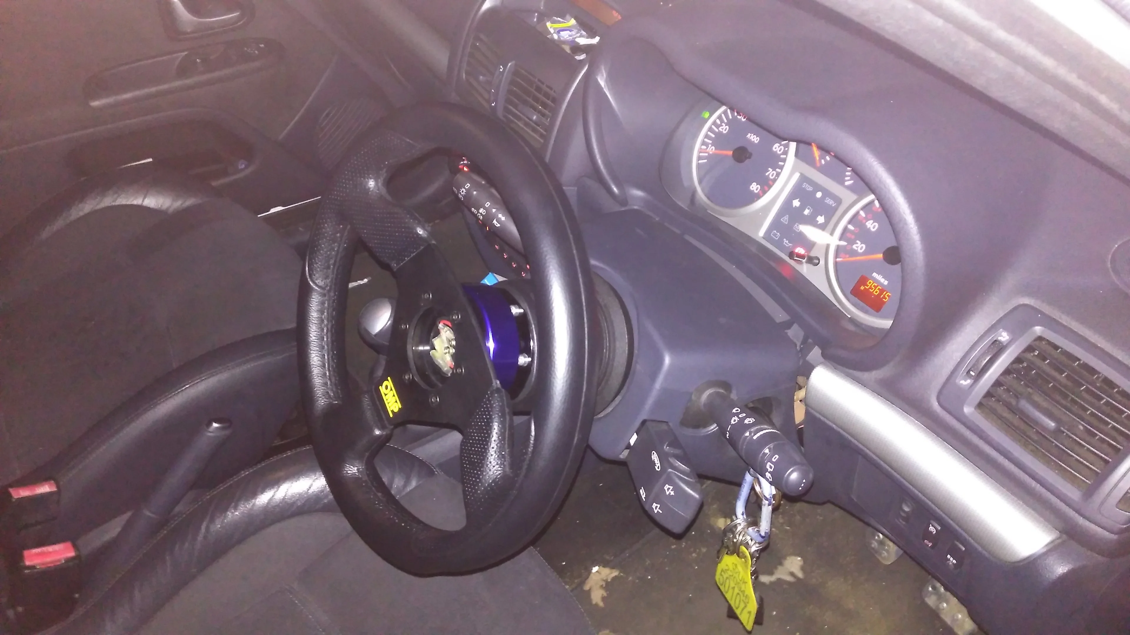

Personally i've got a 300mm OMP wheel in Poly, with the Momo boss as suggested (has the little tab for the steering wheel angle sensor). I've also got a DND Snap-off boss and i've managed to make this work with the Cruise Control adapters people sell on here time to time. My mates reckon i've got wireless NOS but i'm not sold 😂
Fitting is easy, trickiest bit is getting the airbag out but that's about it

Really bad photo from before the cruise control switches were added, the addition of the snap-off boss does bring the wheel quite a bit closer to you but its optional obviously!

Whatever you do make sure the wheel is genuine, seen enough mates with replica nardi's and sparco's fold them in half when it comes to accidents... Same with the snap off if you're going that route, the cheaper 'ebay' specials' wear out stupidly quick inducing a scary amount of play, wouldn't surprise me if it would suddenly unlock on you... I bought the wheel from a website called YBRacing mate, was around £120? it came with a OMP Boss which functionally fitted but didn't have the tab for the Steering wheel angle sensor. The snap-off boss was from Stealthy Garage when they were still abount (used to do JDM Scene kid stuff now they've rebranded to Death or Glory clothing). Ended up picking up the Momo boss for around £40 second hand off here, along with the cruise control panel for another £20-ish second hand off here! You'll also need some resistors to stop the airbag light coming up, cant remember the resistance value but i think they were literally around 60p for ten from Maplins!
Hope this helps

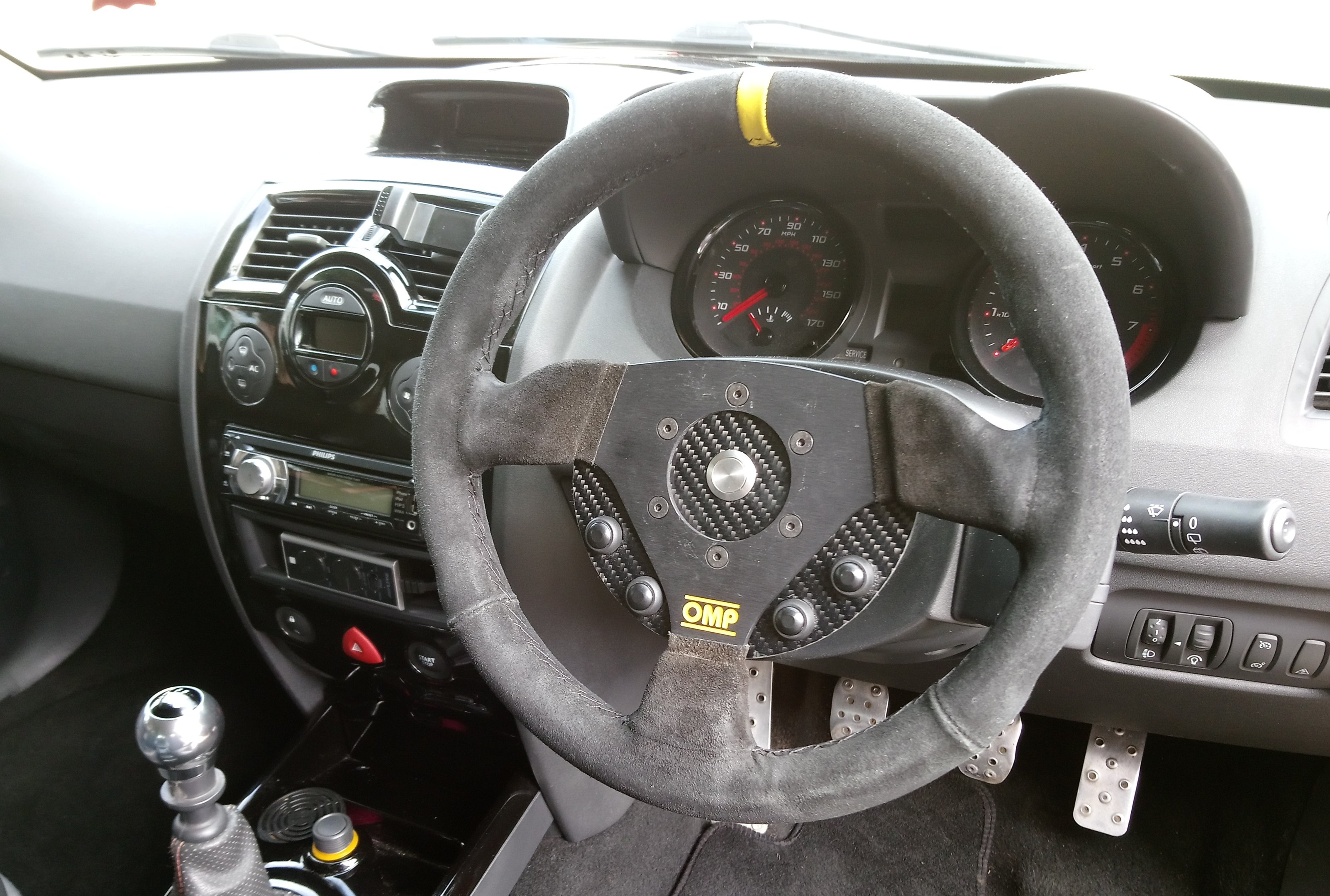

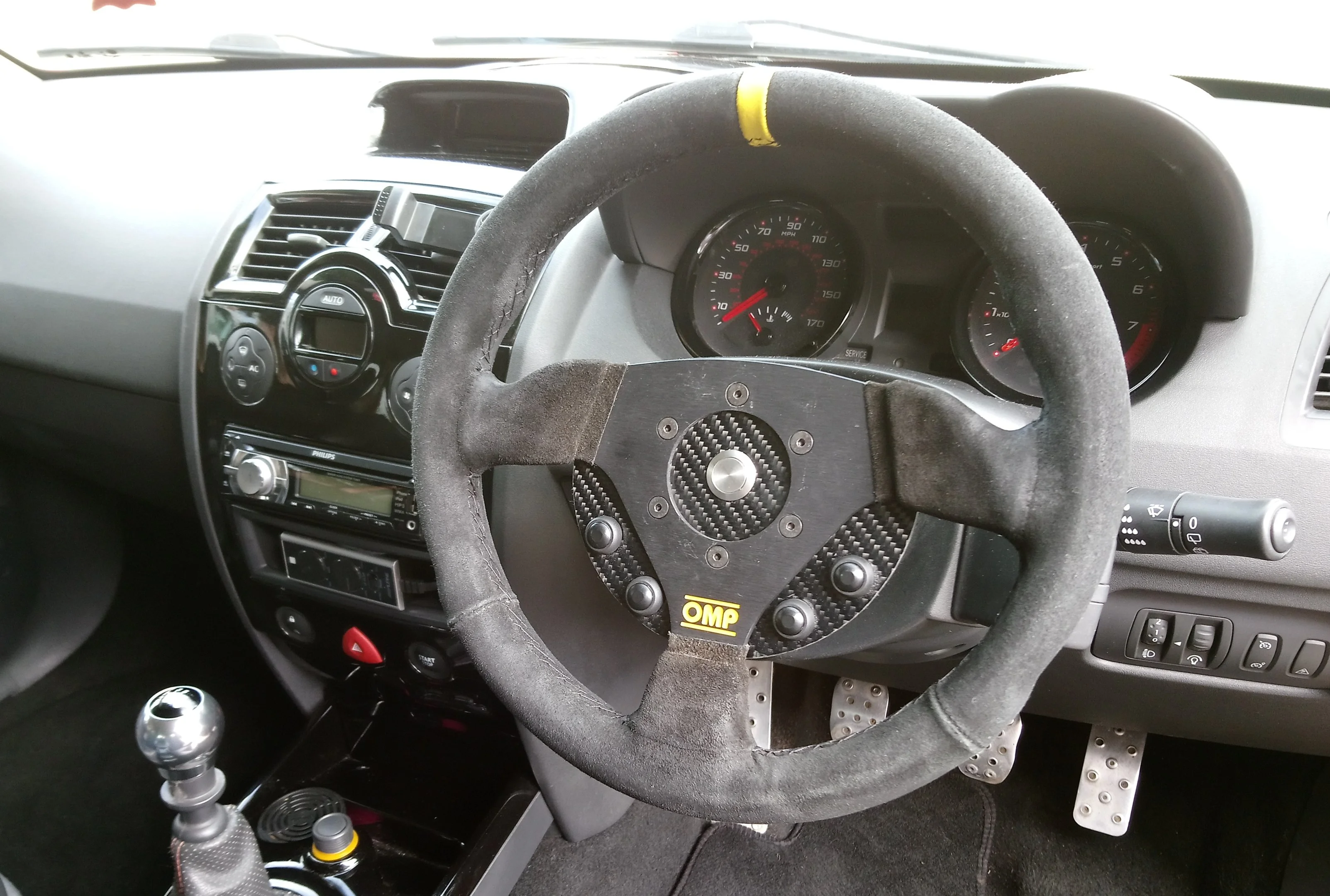

Had a omp trecento uno in my old clio cup and have a he suede version now in the megane.
I personally love the 300 mm size, gives me loads of control. Get the polyurethane or leather versions though as the suede is a pita to keep clean.
Fitting is easy. Bit fiddly but easy. You'll need some 3.3 ohms resistors for the air bag plugs (srs) to keep the light off on the dash.
Dont use the spring clip on the centre horn if you get one with the wheel as it'll short out. Just wire up some spade connectors for the horn or relocate the horn.
