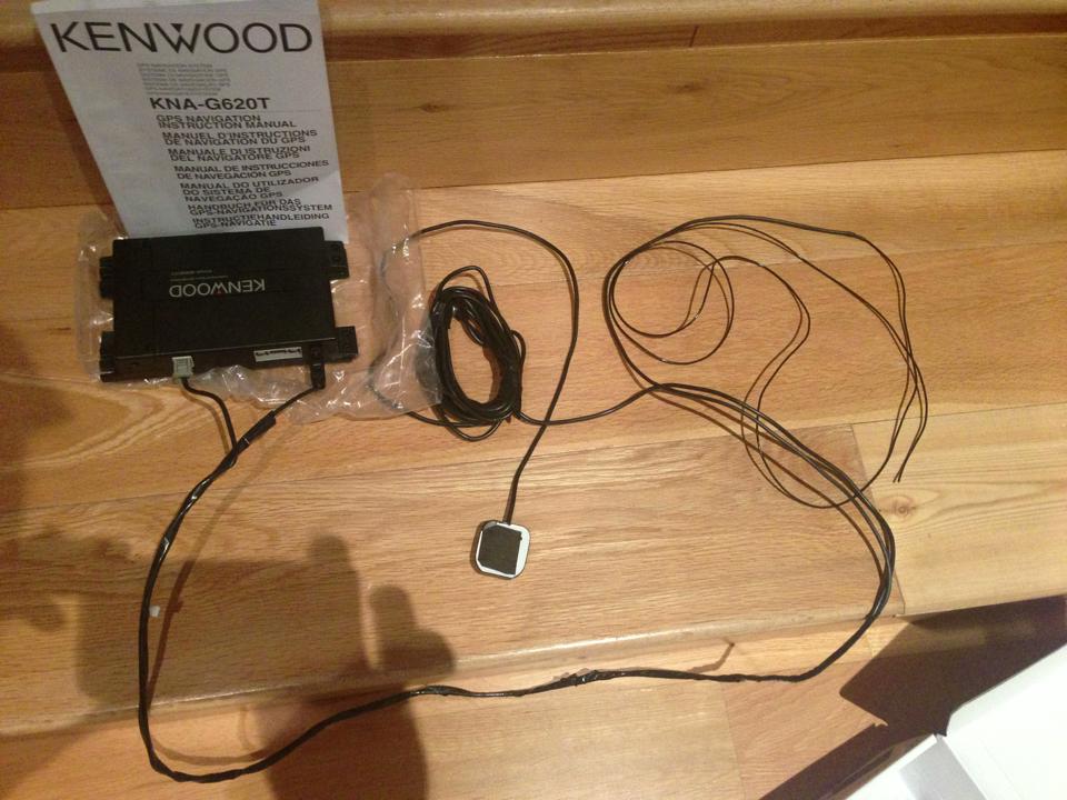

On my system the Garmin has an external antenna which is a sqare thing about 4cmx4cm. It has to go at the top of the car. The Garmin also has a FM antenna but this is used to pick up traffic info in the US, and doesn't play a part in actual navigation. My Garmin's pretty good, and never loses signal unless underground so I definitely think you've got a setup issue there.
EDIT: GPS antenna is in the middle of this picture (upside down)
Yeah the GPS Antenna makes sense when I think about it.
