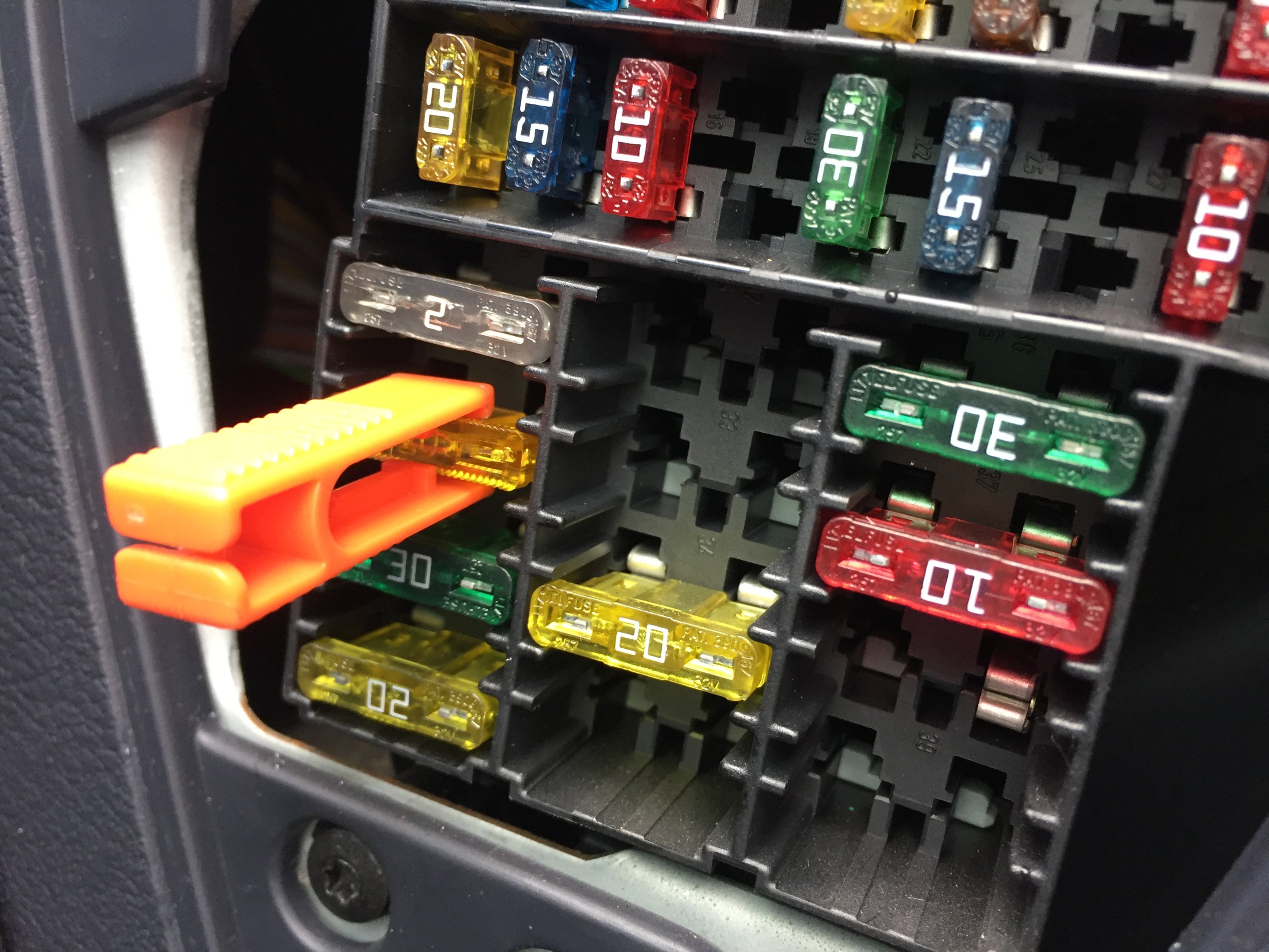

Hi my Clio 172 has an issue at the moment where the stereo, clock and interior lights are not working.
I have checked the fuses by the passenger side door and they are fine.
Any ideas what could be causing it? Thanks
Update - I checked all the fuses again and found one of them had popped (large 20A).
Replaced and it is all working fine again.
Picture of fuse in case this helps anyone in the future
n.b It is the one with the fuse pulling tool on it:
