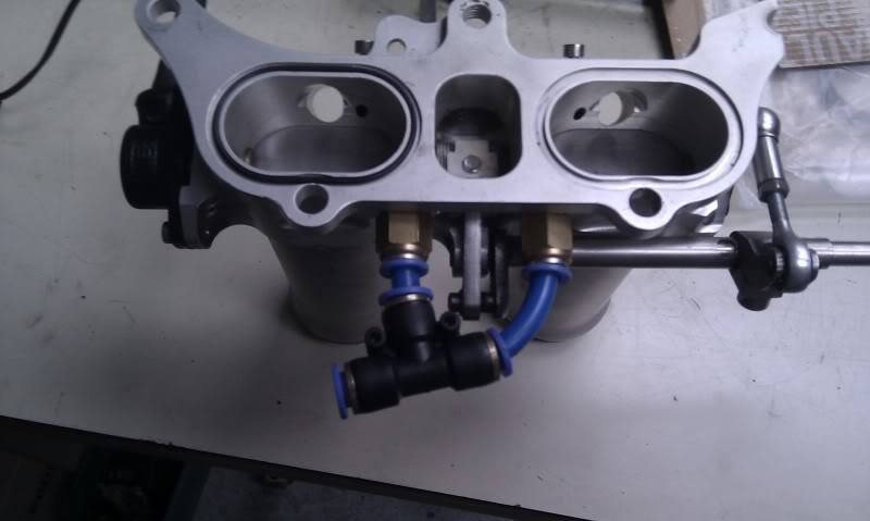

Brakes were really stiff to use, I located what looked like air leaking from a fairly shoddy vacuum set up. (On ITBs) Danny at 519 has made a nice tidy replacement job for that - which improved pedal feel slightly, but did not solve it...

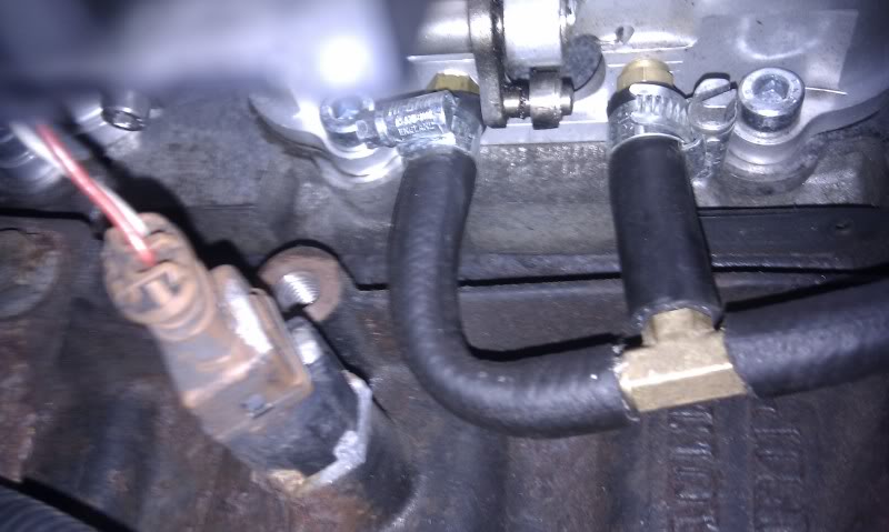

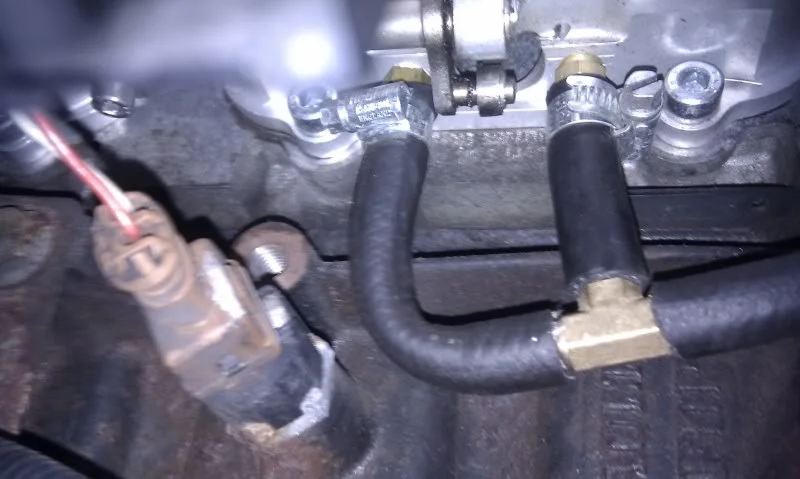

It's got a very hard pedal like you get if you pump the brakes with the engine off. Car had brake issues before with the previous owner, and a new one way valve improved it. I changed the shoddy servo vac pipes on it as they were leaking, kinked and too soft so being sucked flat. so there's actually a bit of travel there now, but it's not right.
before
After
Could be the servo itself (although thats a very rare item to fail on any car) or it could be down to a lack of vacuum at idle, and the way the ignition is mapped (seen it makes quite a significant difference on a couple of cars). Was difficult to tell before as the EBC blue pads were well past it (looked like they'd been on fire) and the discs were glazed

Woah that is a terrible servo setup. Who installed that??!
