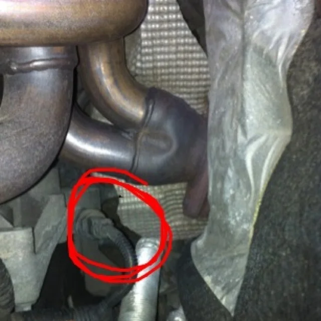

The picture is the location of the sensor on my '02 172. There's a heat shield which I've removed btw.

It will be the speedo sensor as mentioned above, it's actually harder to see on a 1.2 8v than it is a 2.0 (lol) but it is in the same place.
To remove it you twist a quarter turn or similar, very easy to change and only about £25 from Renault.
