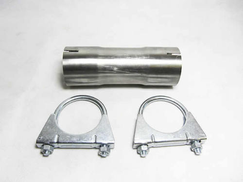

It's possible to do on the cheap if you are handy with tools. Take the current centre section off and cut the silencer off, buy a straight 2.5" piece of pipe long enough and connect it up with something like this:
