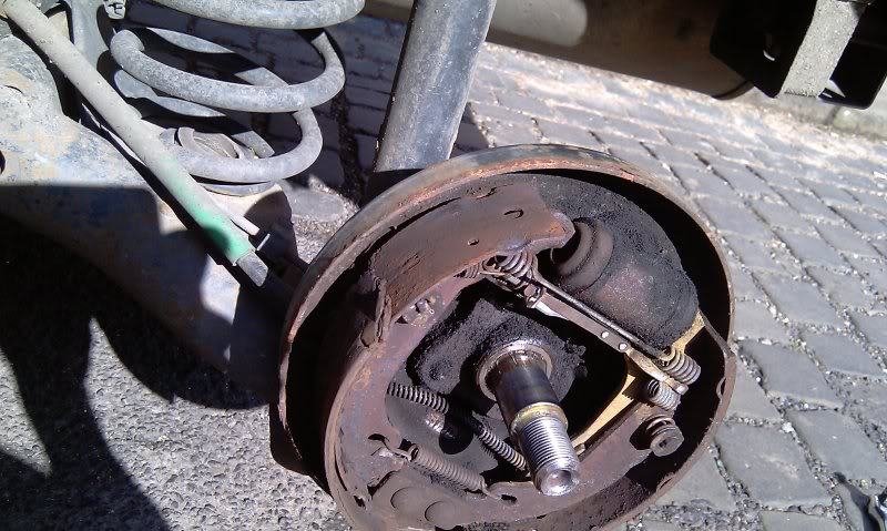

It finally decided to give up completely on Saturday night when I set off to go to my mates house who has a garage to fix it. In the past if it stuck on it would release itself if you drove off but this time there was smoke pouring off the rear wheel when I got about a mile away so it wasn't going anywhere. I had to fix it outside my house in the road which I hate doing cos you can;t trust all the Pikeys walking past not to nick your tools.

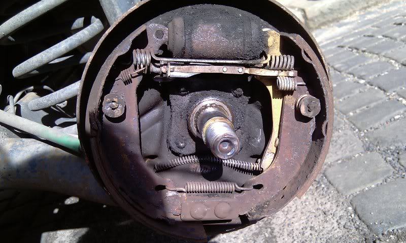

Here is the state of the old shoe on the left hand side. Totally broken in half. No wonder it was sticking.
Not a hard job in the end. Takes a bit of fiddling to get all the springs back together but not too bad. Hardest bit was getting the seized drum off but it soon shifted when I reattached the wheel and gave it a proper good pull. :approve:
