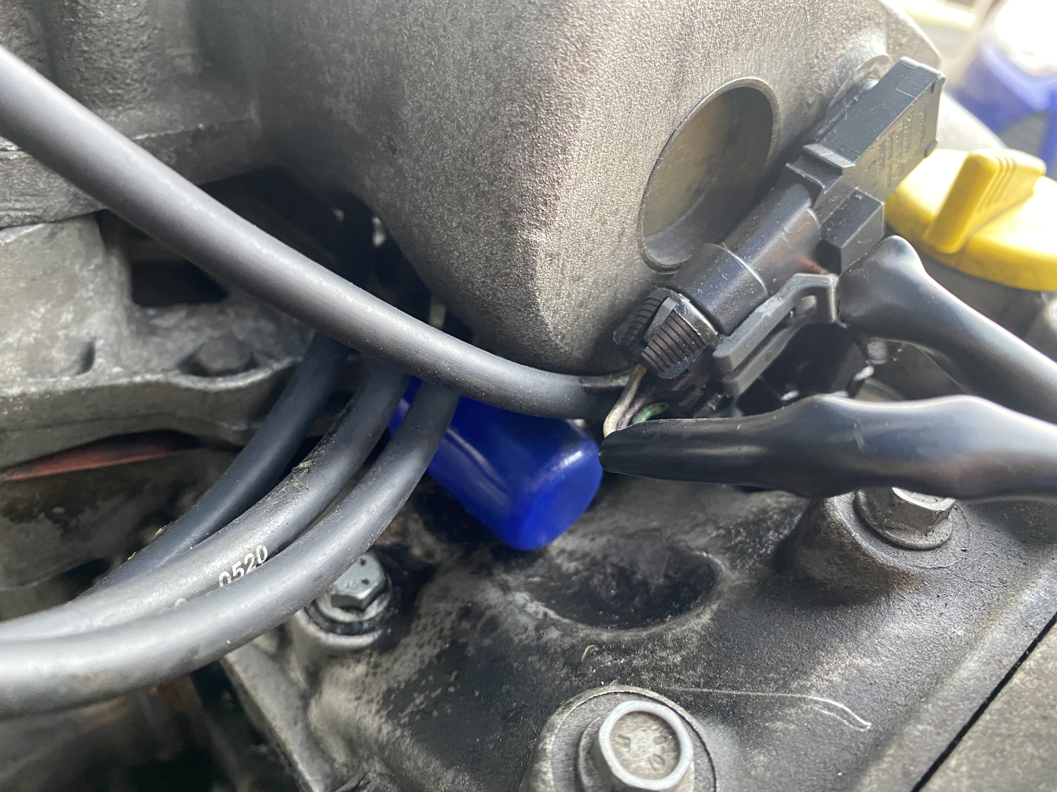

Is it fine to have this little port completely blanked off under the inlet?

The blue bung is just blocking the carbon canister pipework which does not usually cause an issue, assuming its clipped on/not leaking.
Check the exhaust is not blowing
Yeah I’ve just had the manifold off, fitted decat and new induction kit and that’s not solved it unfortunately. I think it could be the crank pulley.
