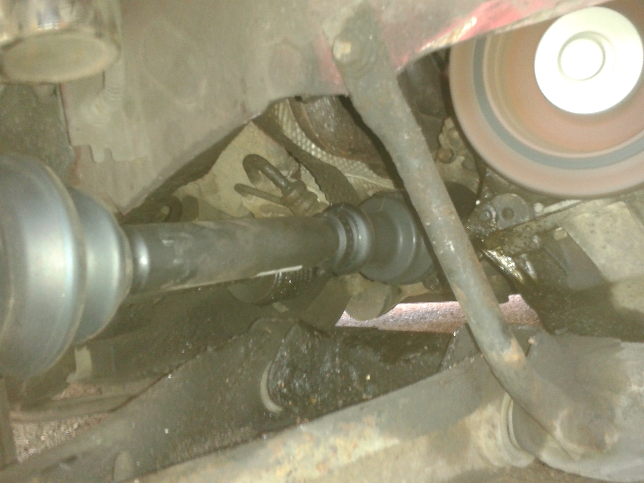

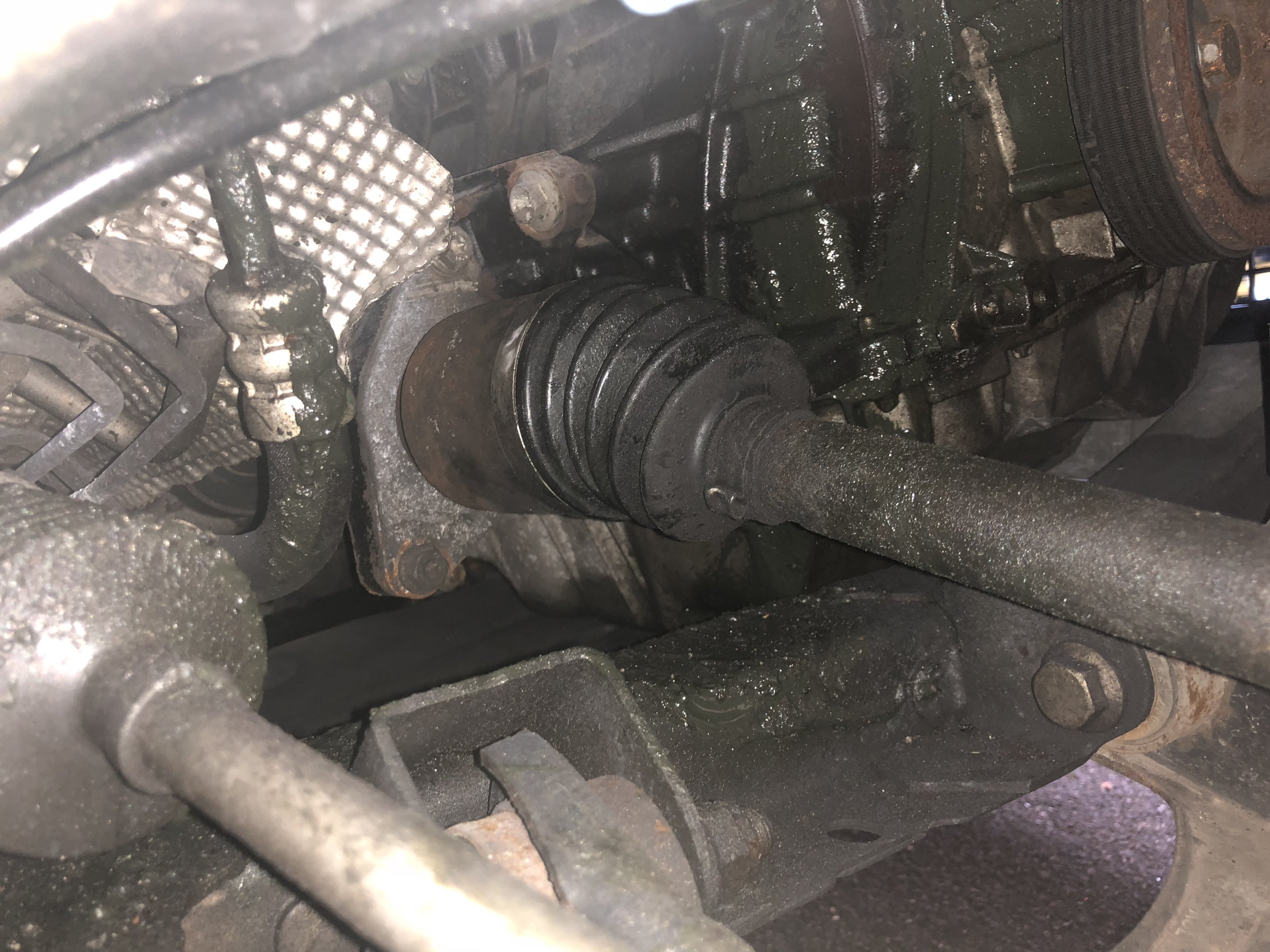

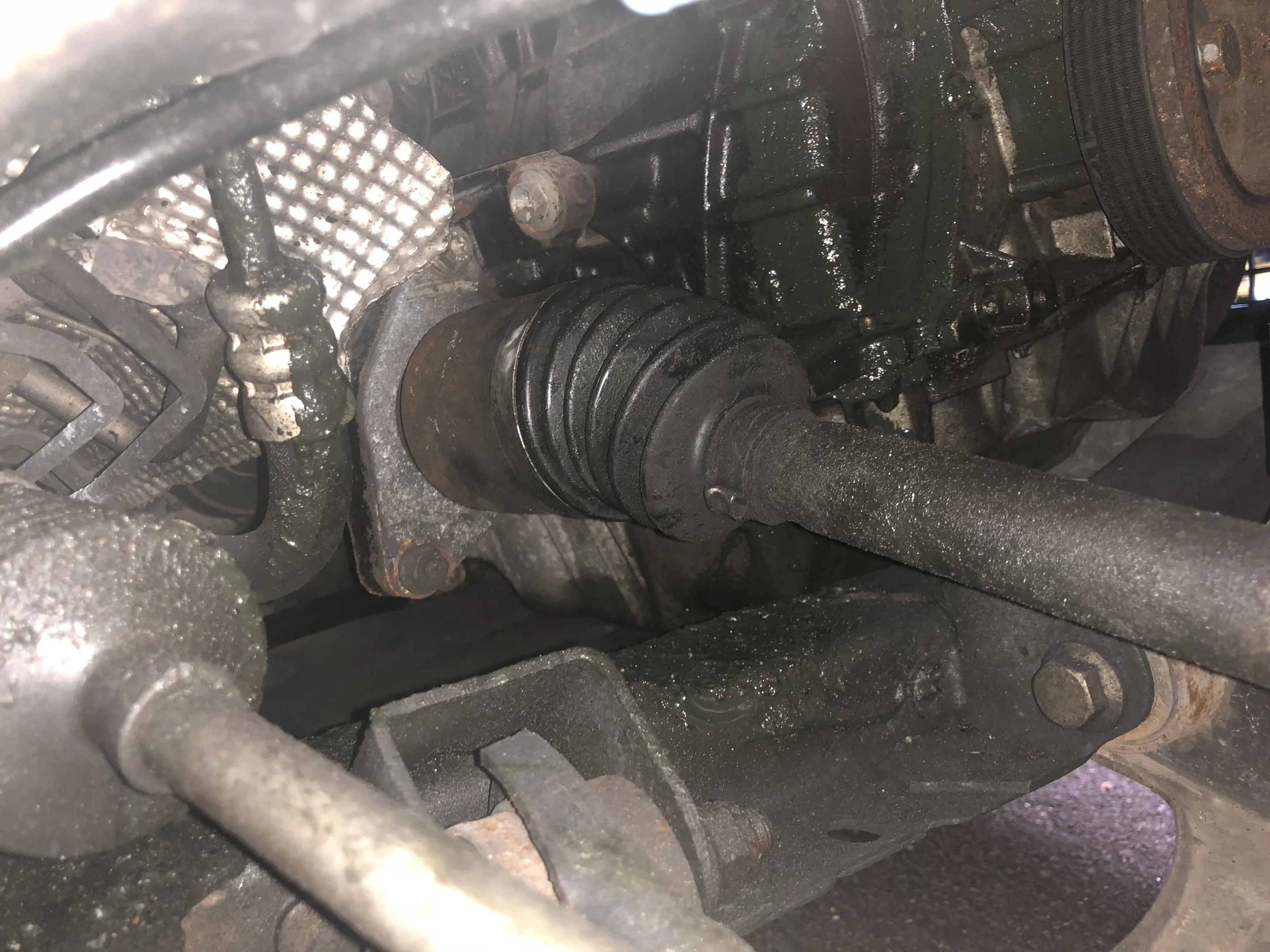

Thanks for the reply, the fact it’s so inconsistent is what’s confusing me but I jacked it up earlier and noticed the inner cv boot on the drivers side has thrown all its grease out so that must be the cause of the problem. That driveshaft is bolted to the block too which would explain the vibrating of the whole car!
I’ve got a load of upgrades and bits I want to renew on the front so just going to stick 2 new driveshafts in it while I’m at it so I know it’s all good for the future

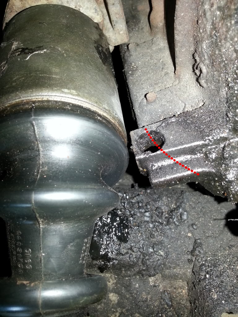

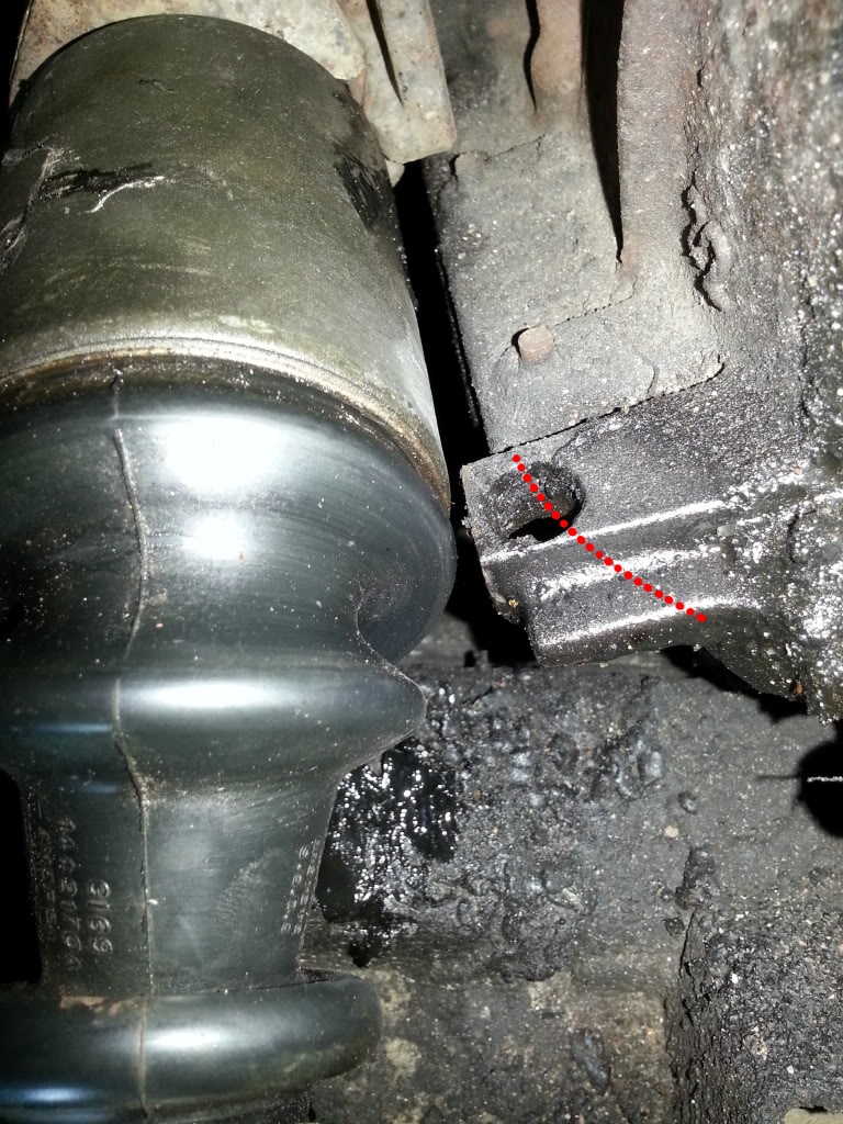

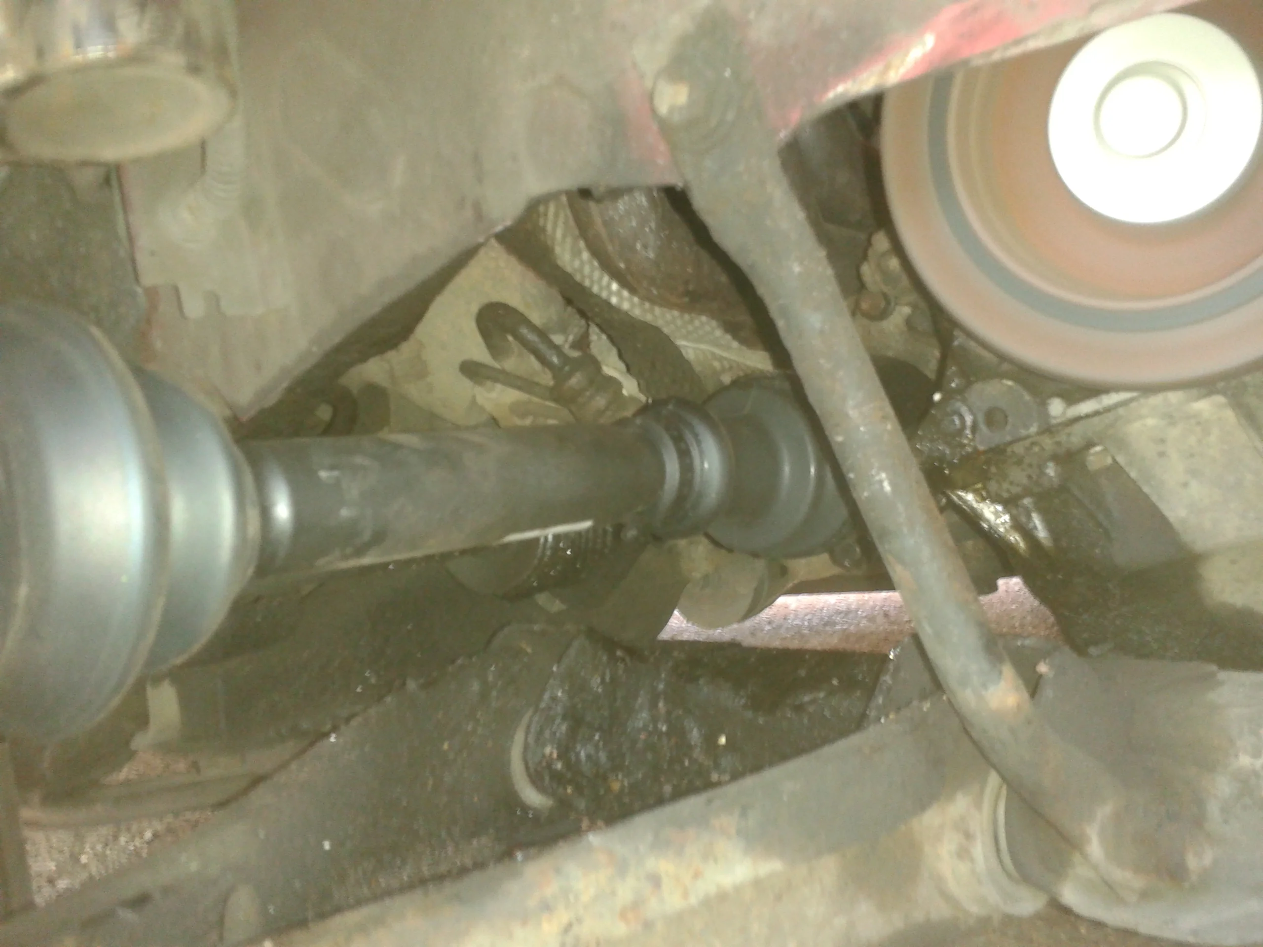

A word of caution, where your inner CV boot has split and thrown grease all over the back of your engine has been a problem with the RH J&R shafts with the support bearing.
Something to do with the boot being oversize/wrong spec and catching on the back of the engine block.
You could try and get a good price on a Shaftec item, R396R from a motor factor like Andrew Page, the ones on Ebay are too much.
Or you can grind the pointy bit off the engine block.
I`ll see if I can find a picture.
Ok thanks for the help! I did notice earlier that the boot is very close to the engine block! Just don’t want to spend the earth on new shafts
