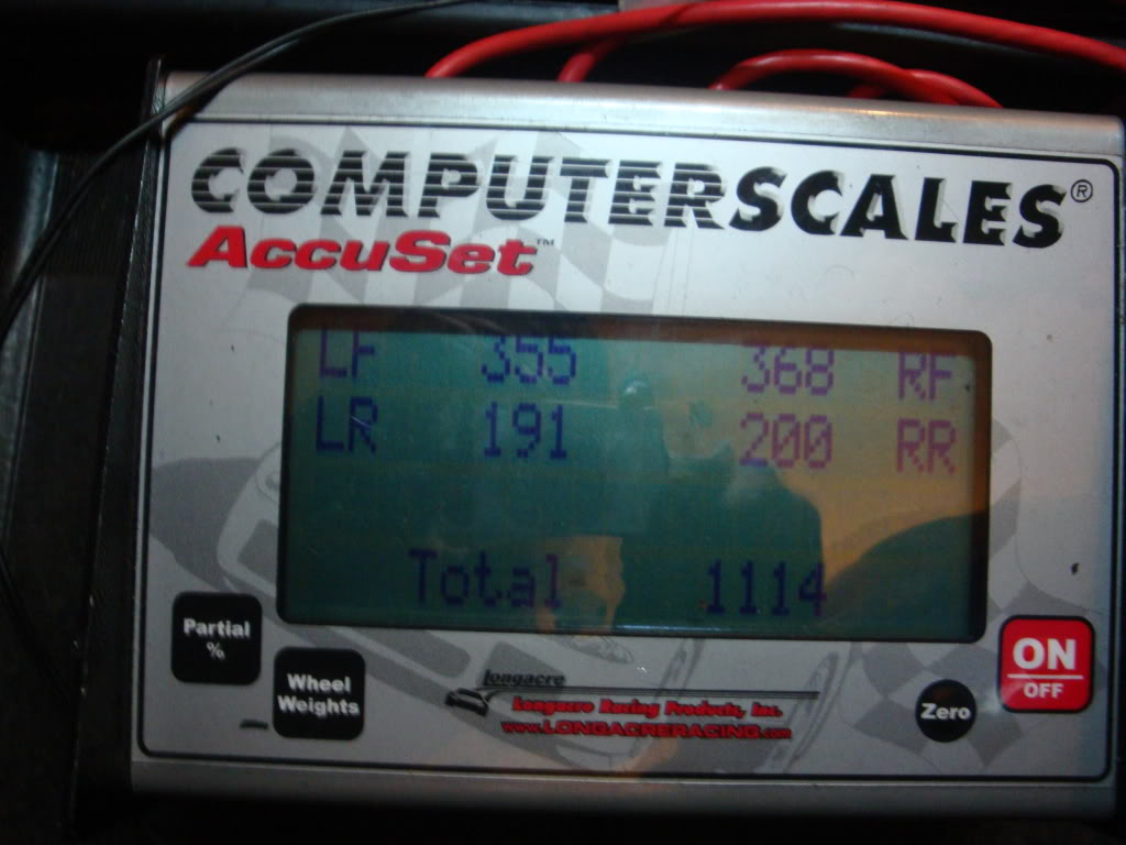

If you're trying to compare the weight released by Renault with your car, you'll be playing a bit of a guessing game..... I work in the weights department at JLR and so I'm up to speed on certified weights. Basically, the jist of it is, every production vehicle is certified at Base Curb Mass, which is 100% fuel, no options, no driver. And then, when it comes to actually weighing the vehicle with the VCA (Vehicle Certification Authority), we're allowed a COP (conformity of production) of 5%. Therefore, as long as the vehicle actually weighs within 5% of what weight we release, then that is the weight we release.
Proof of this is in the pudding. We're currently preparing my 172 for the tintops and we weighed it in at Base Curb Mass using corner weights. As you can see from the pic, it comes out at 1114kg, compared to 1035kg as released by Renault. This is 7.6% over the certified weight....which means that things like air con would be down as free options or such like. So they'll "walk" off the weight of these things to get under the 5% mark.
We've properly stripped ours now and we're going for polycarb windows, and have a bolt-in cage to go back in as well. When it's done we'll be wacking it on the corner weights and seeing what we manage. I would love to see it under 950 with full fuel, but I haven't weighed the parts coming out. I'm pleasantly surprised to see the burpspeed car around the 850 mark...here's to hoping we can match it.
