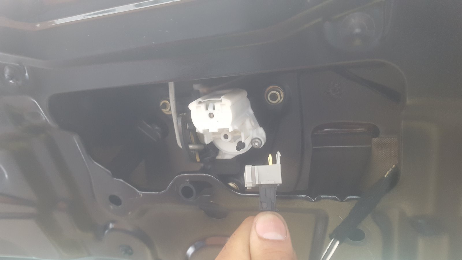

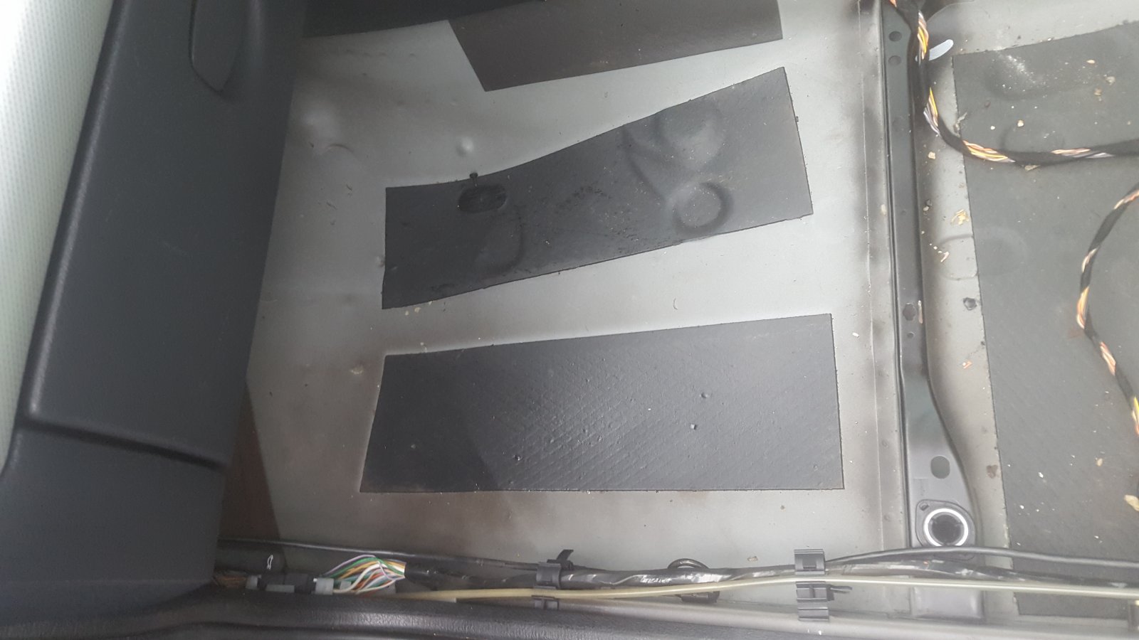

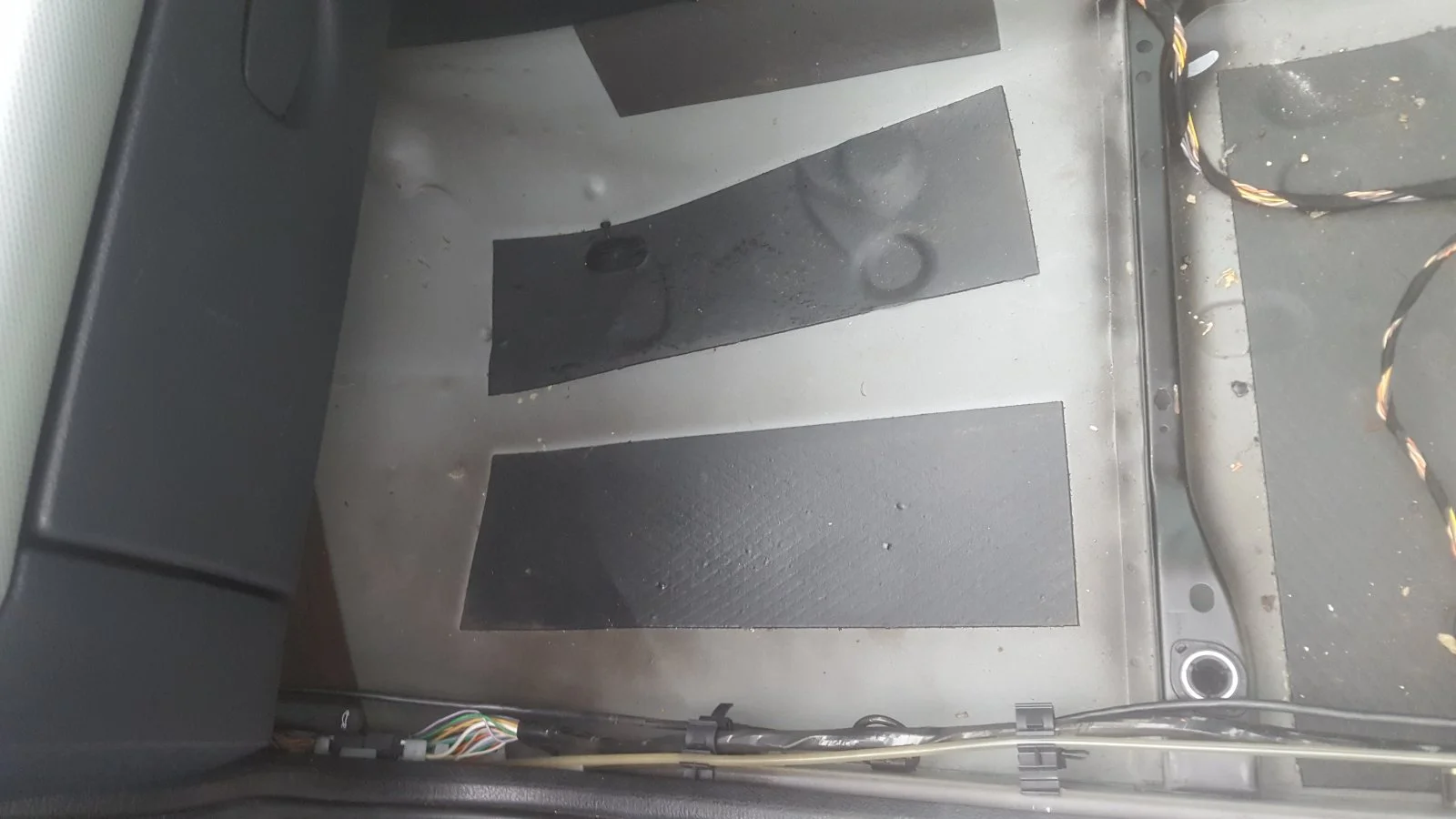

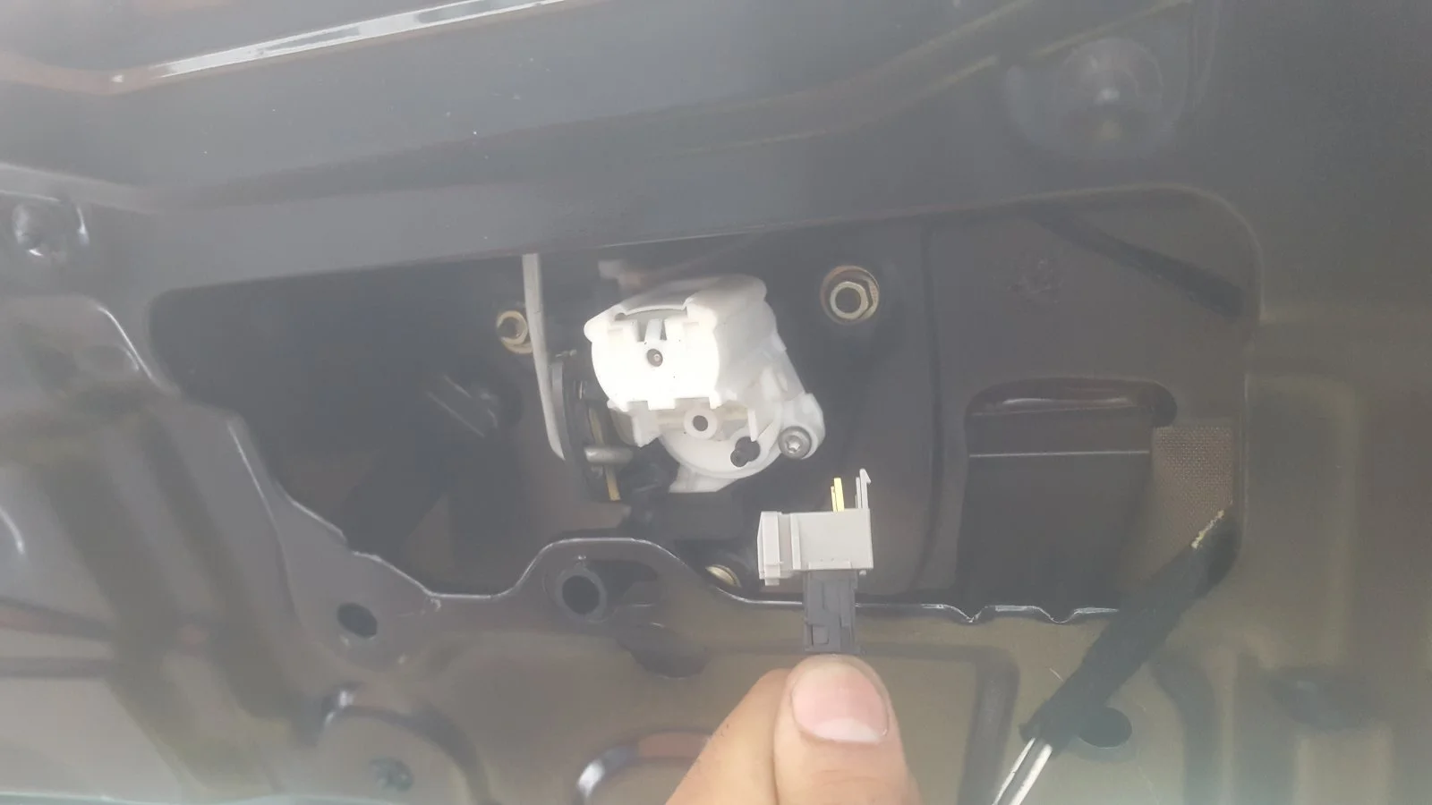

Couple of questions for you all, was stripping my track clio 172 today and while i was taking the rear wiper out, i pulled the plug out the boot lock so now it doesn't lock with the central locking when pressing the button on the remote, I have looked and looked an i just cant find where its supposed to connect, i have included a picture. An also what is the best way to remove the sound deadening from the floor? i havn't actually given it a go yet but it seems like its glued on strong an will be a bit of a mission to remove. Thanks

The sound deadening is going to take hairdryers, chisels and swearing I suspect :(
Heatgun and scraper. Can use dry ice too if you want. Be careful on the roof as its much thinner.
I used a hairdryer to remove mine, found it to be a bit more gentle as opposed to a heat gun, came off fine and then removed the left over glue residue with some autoglym tar/adhesive remover
