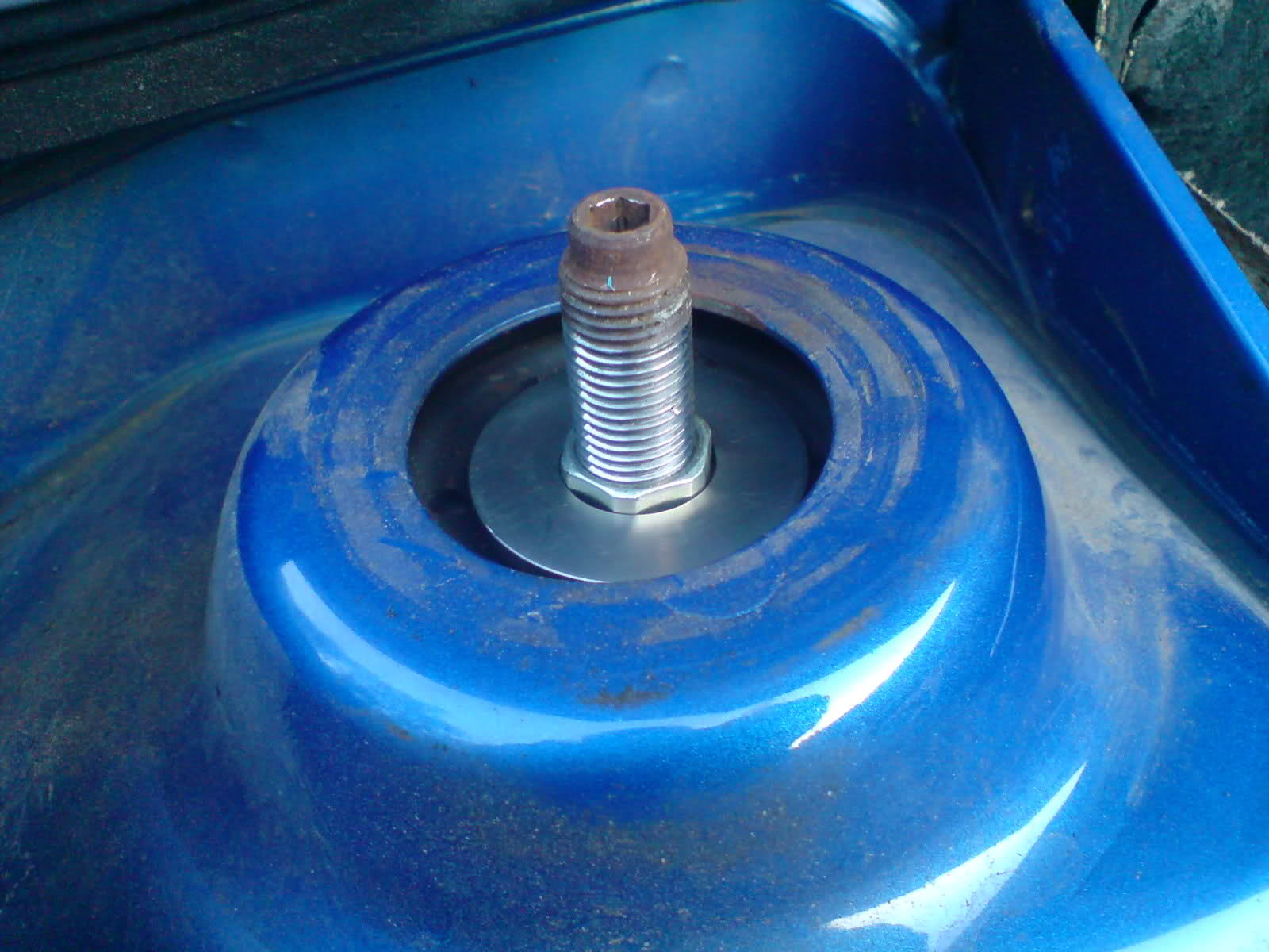

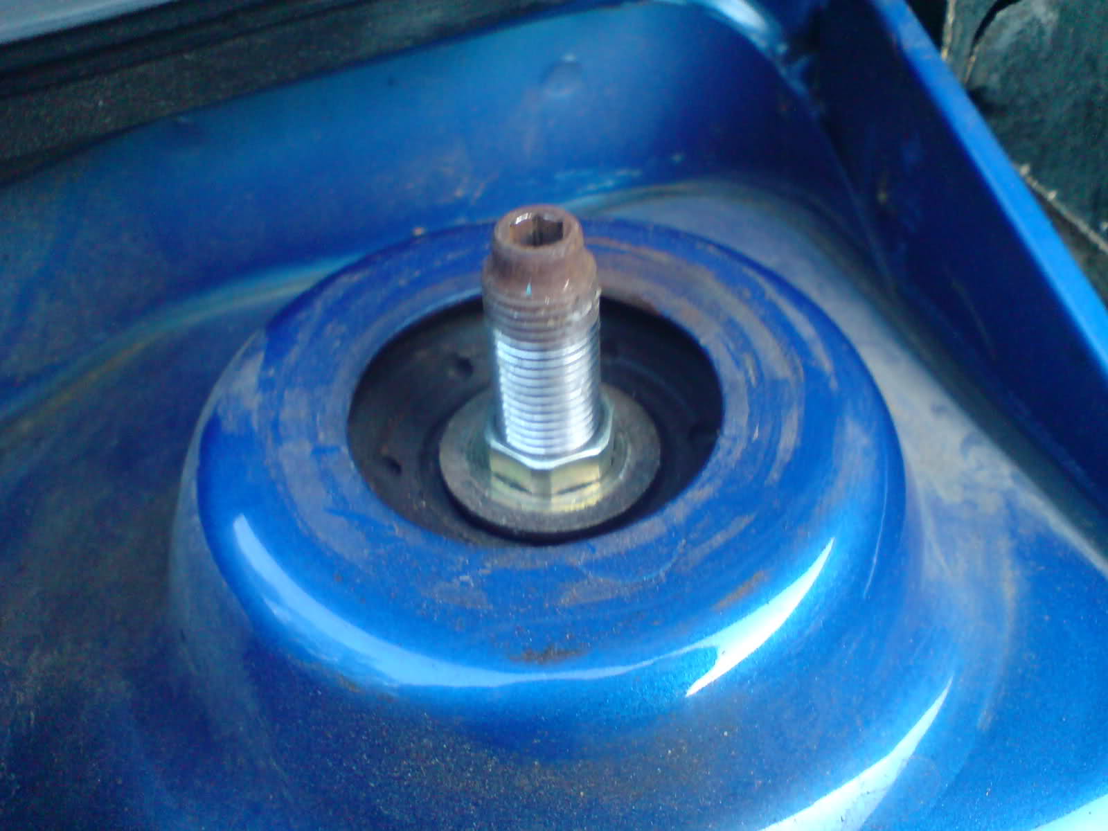

Is this right, as i cant see how the washers will do anything in that position, also i still have knocking...
Took the black rubber bit off...
Then dropped the washer in...
Then replaced the black rubber bit. That right?

Thats right, the knocking is usally the top part hitting the turret and you can see by the metal worn away on the opposite side, the washer is just to raise the top part so it clears the turret.
Oh i see, wonder why mine is still knocking then?! Could be lower arm bushes or something else then i guess, will have to have a look.
