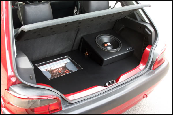

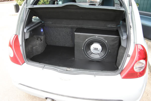

the easiest way is to build a false floor, build a wood frame with either a solid mdf board on it so you can maximise bootspace or with an amp window. the sub box is sunk into the floor, trapping it in place.
the board can easily be lifted out to give access to the spare wheel well
heres one in my clio and one in my bros old car
