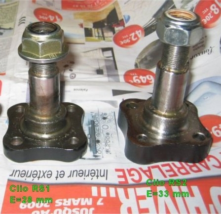

Hi. I’m looking at at doing a refresh on the suspension and getting things painted etc. just wondering are the 182 cup sub frame and rear beam different to a normal 182? As I might try and pick up some spare and just get them built up and swap them over.
Thanks
Subframe is no different.
Rear beams are all the same too, apart from the cup packed stub axles are a bit thicker so wheels are spaced out more.
